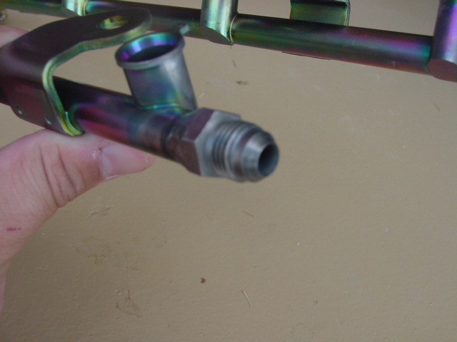

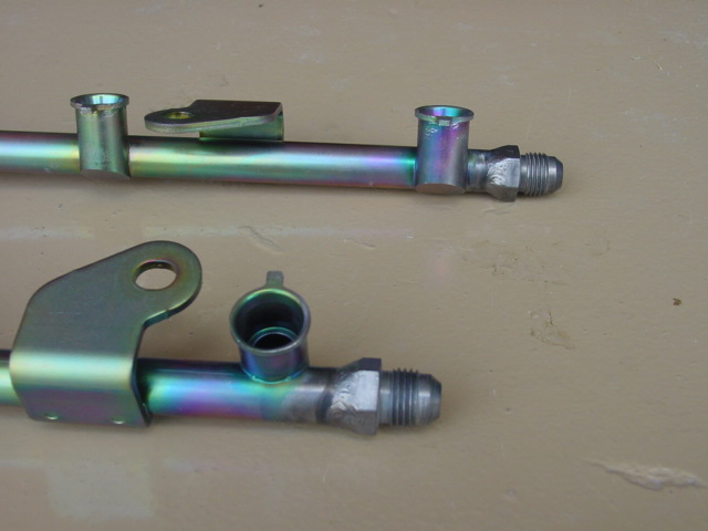

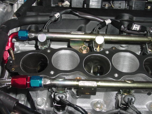

I have this pictures of the stock fuel rails, with 6N fittings welded:

I Tigged a Bung into my stock Rail-with no prob --After the Tig I Brazed a coating of Brass over the weld just to guarantee a good seal. U have to be very sure of routing though

Originally Posted by DMK
How hard was it to do that?
I have no idea, just sent my fuel rails to a shop and they did the work, but think isn´t hard to do.
