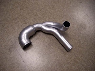

Do you have a plan to make something better than this while still using our stock intercooler?
Attached Thumbnails It's *finally* Begun.. Engine Build!-intercoolerypipela3.jpg

yessir-
probably going to use the original prototype design Richey made and make it a much wider collector:
if not, i might got the way KTaylor did and go with a custom endtank to the original ARC intercooler and just make two inlets.

yeah, that peice looks good^ and looks to be better flowing to. Im looking foward to the new numbers becuase that PE collector pipe was very restrictive. do a before and after dyno if you can. i wish i had to compare but i have a bunch of other changes so i wont be able to tell what just changing that out did as far as gains.
