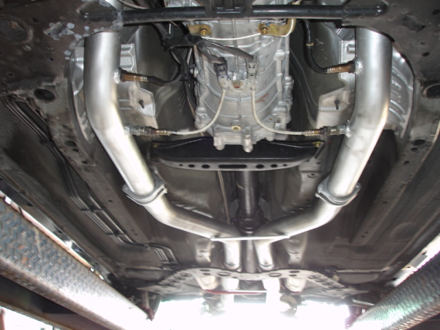

I had two widebands in this pictures thus the 4 bungs (2 OEM, 2 a/f).
