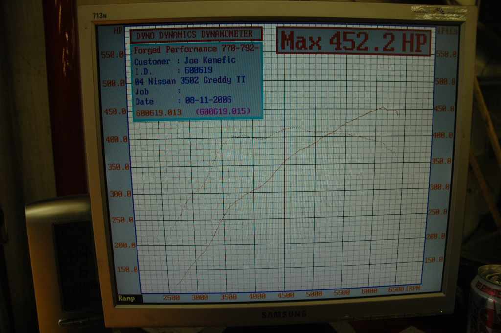

Drove from Indianapolis to Sharif's shop in Hotlanta, when I got here we did a base line dyno of 426.8hp on 10psi, pump gas,emanage blue (self tuned, with some help from the forum), etc...
We installed the UTEC, 650cc injectors, and the ATS triple disk clutch... On the same 10psi of boost and pump gas Sharif was able to bring it up to 452.2hp!!!! That is 25.4 more peak horsepower with only changing to the UTEC and letting a master tuner like Sharif type on the keyboard for a while...
Now a 25.4hp gain is impressive, but that is not what got me excited the most. The "meat under the curve" is absolutely amasing!!!! Through out the entire mid range we saw gains of 50ft/lbs of torque and 35-40hp. If all I cared about was peak hp then I would have bought a Supra! Sharif was able to incease the usable part of the power curve significantly, trust me you can definately feel 50ft/lbs of torque on the butt dyno! There is over 400ft/lbs from 3600-5700rpm, and this is with open wastegate dumps.
I think that is as far as I am willing to push it with the Stock Block for now, maybe a water/meth kit would allow for a little more safe power, but I am one satisfied customer for now! 452hp on his dyno with no correction should be the stock block record at Forged Performance, this should be just over 500hp on a dynojet. Not bad for a stock block car on pump gas! I plan to head to a dynojet when I get home to show you guys the difference between the 2 dynos. So, who is next? The other thread had some poeple stepping up to the plate... Records are ment to be broken!!!

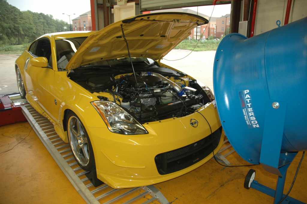

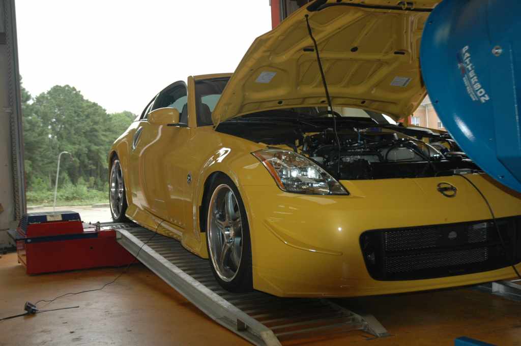

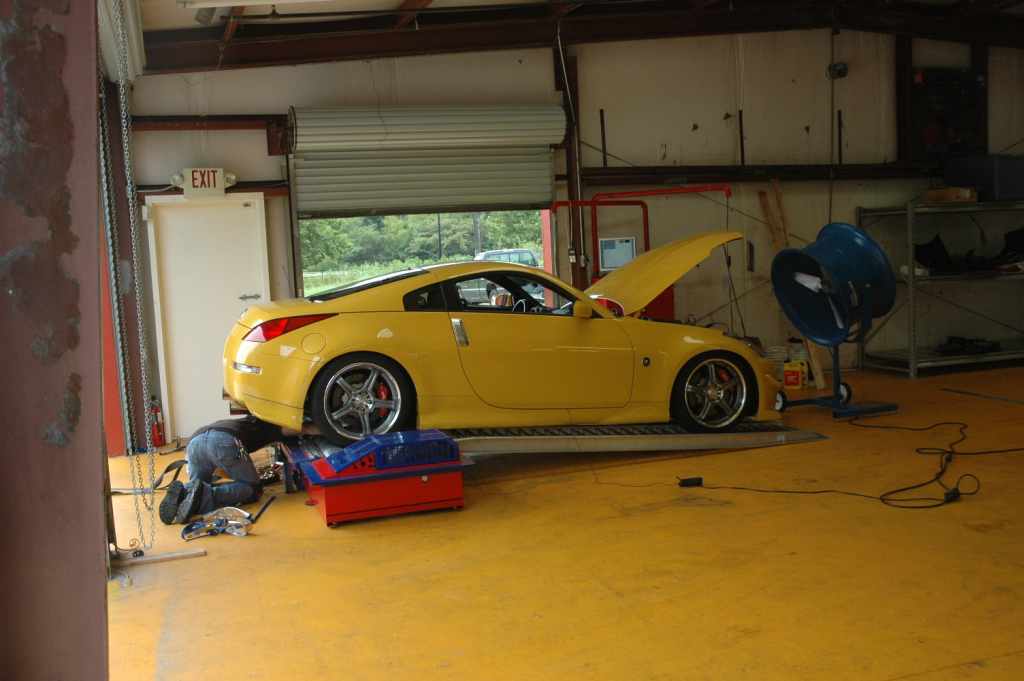

Here are the pics... when I get home I will post some better ones of the car.

How did the huge fan do? Nice numbers and to be expected from Forged!!!

That was at CP racing... they use a correction of 13%... Guess you will have to set the record when you get down here next week! Good Luck!!!

i believe your car was tuned prior to when Sharif decided to stop using correction... so your numbers are probably corrected numbers
