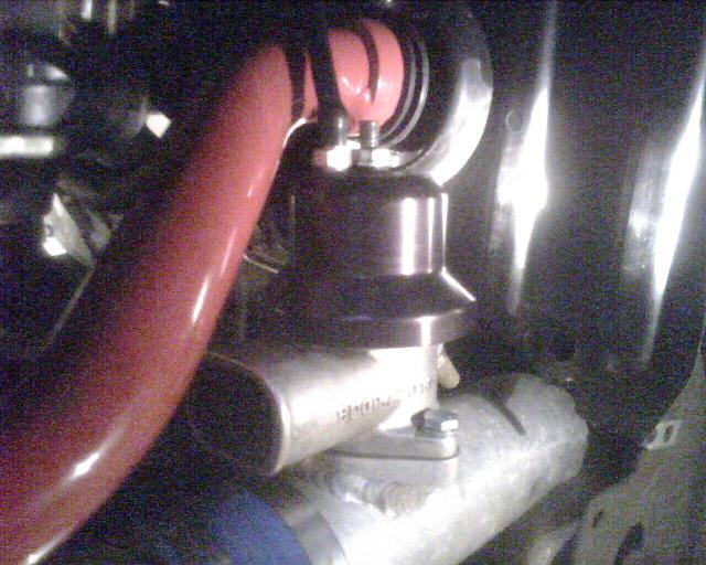

So here is a picture of my bypass valve. I tried turning the screw not connected to the vacuum line, but it wouldn't turn any more than 5 threads. I am guessing this is the wrong screw.

yours looks to be about right
Looks about right...you have to make sure you loosed the set nut first, then with an Allen head wrench, turn it in to about 6-7 threads showing above the nut, when tightened.

So I was turning the right nut? If so, allen wrench? I didn't see any opening for an allen wrench. So, I basically take off the hex nut on the bolt that is further away in the picture and then use the allen wrench where?
Ps. I would like to make the BOV close a little sooner, because I am getting a whistle when taking off from a stop every freakin time and I think it is the BOV.
At the top of the stud, there is an allen head fitting...as if it were a screw, pretty hard to see, but it's there.
