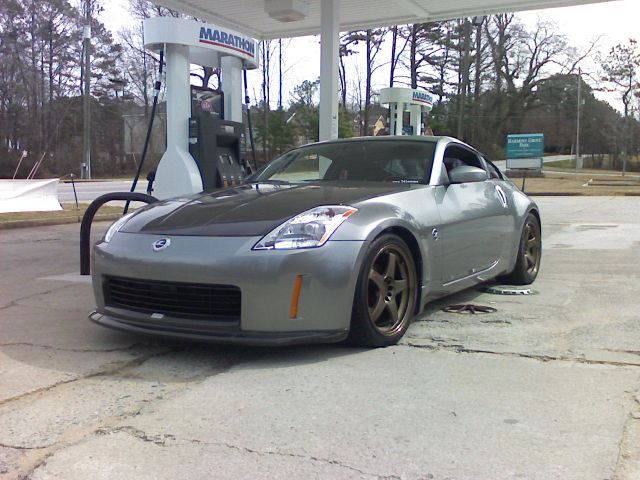

so far no pics, just one with my camera phone..lol
Old Mar 5, 2007 | 06:27 AM
  #54
original786's Avatar
original786
Posts: 370
From: Atlanta
pic

Looks good. How about some pics of the kit?...

simple and clean. we need more vids.

Nice looking car. Can't really see the IC. Somewhat sleeper besides the visual mods.
And I think the only thing you will see with the kit is the intake-to-IC pipe If you can relocate the BOV on the APS ST you can have a nice sleeper
"Nope just an Intake"

yeah definitly a sleeper, flatblack tall boy, flatblack intercooler, no one can tell..
blitz boost controler, in the sunglass visor
