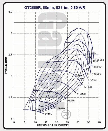

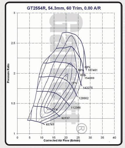

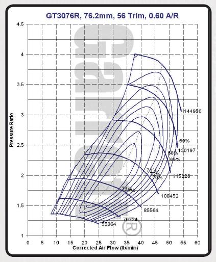

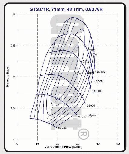

Is it not true the JWT and APS both use Garrett turbos? I have have been meaning to search out the compressor maps and other info about the turbos both kit's. Besides that both kits appear very well made. Also, JWT only lets a authorized dealer install the kits, APS does not care either way. Thats a huge difference. Anyone have the turbo information and compressor maps for both these kits?
The JWT BB 530 kit uses GT2554Rs. The BB700 kit uses GT2860Rs and the APS regular kit uses something resembling a GT2871R. No one knows for sure what the APS Extreme kit uses though...I personally think the APS Extreme kit uses a pair of GT3076Rs but like I said, no one knows for sure...Attached are the compressor maps for the 2554, 2860, 2871, and 3076. That would be the JWT BB530, BB700, APS standard kit, and APS Extreme kit in that order.
Attached Thumbnails APS TT or JWT TT? need help guys!!!-2554akajwtbb530.jpg   APS TT or JWT TT? need help guys!!!-2860akajwtbb700.jpg   APS TT or JWT TT? need help guys!!!-2871akaapsstandkit.jpg   APS TT or JWT TT? need help guys!!!-3076akaapsxtreme.jpg
