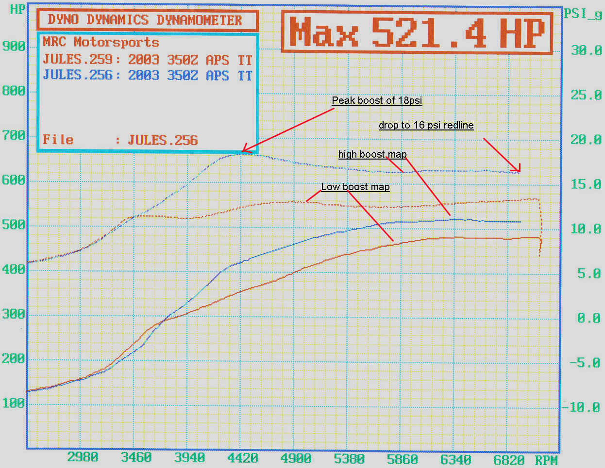

$99 shipped in stock, plus you get a $15 gift certificate towards you next purchase with us , call monday.Comes with instructions, and I have some base maps..
Here are some results of boost mapping on the dyno. We are the ones who figured it out, and we have run it to 18 psi, dropping off to 16 psi, this was an actuator spring issue mostly..Here is the original thread we started.
https://my350z.com/forum/forced-induction/234420-utec-controlling-boost-finally.html

Works just like a boost controller, with alot of the features of the high dollar JDM YO! Boost controllers on the market.
You can keep the wastegate closed below a certain boost level,raise and lower Gain and ramp up of boost, Mapping the boost is dependeant on TPS VS RPM..Works great.The best part is with a simple flick of the switch the utec will change your map and boost settings!!
