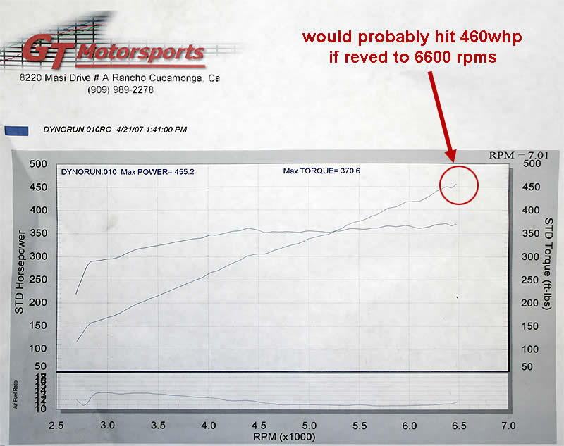

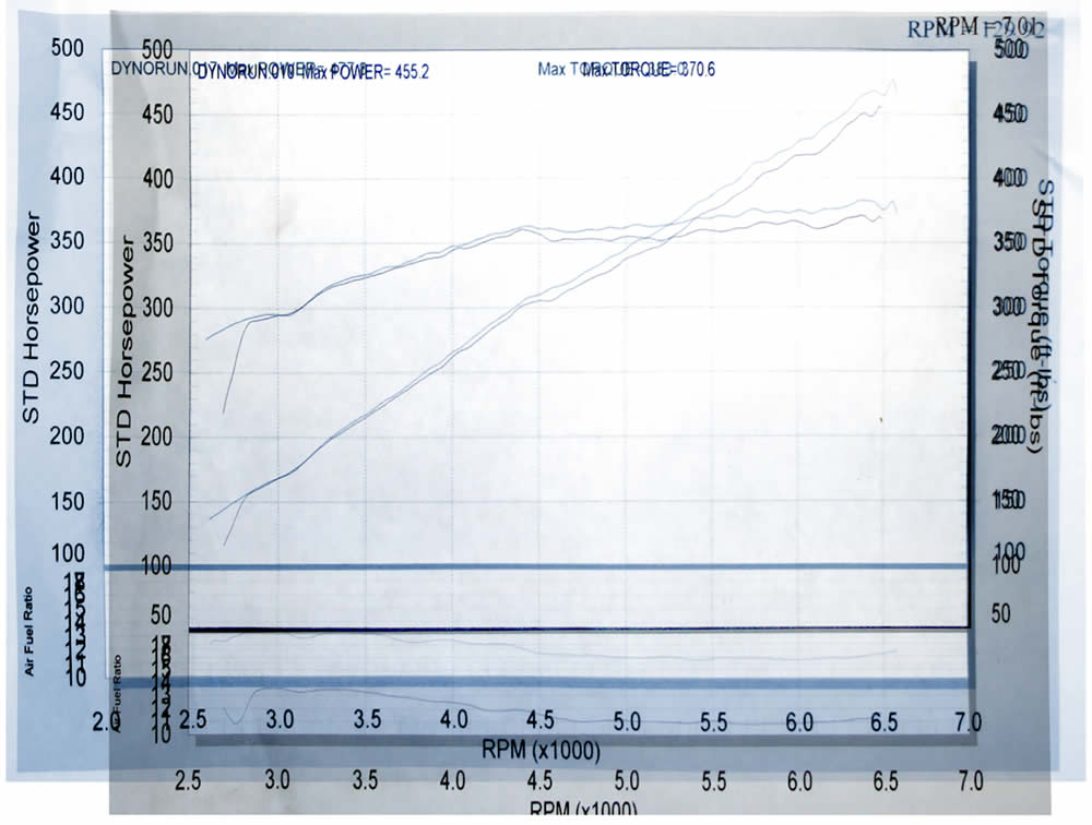

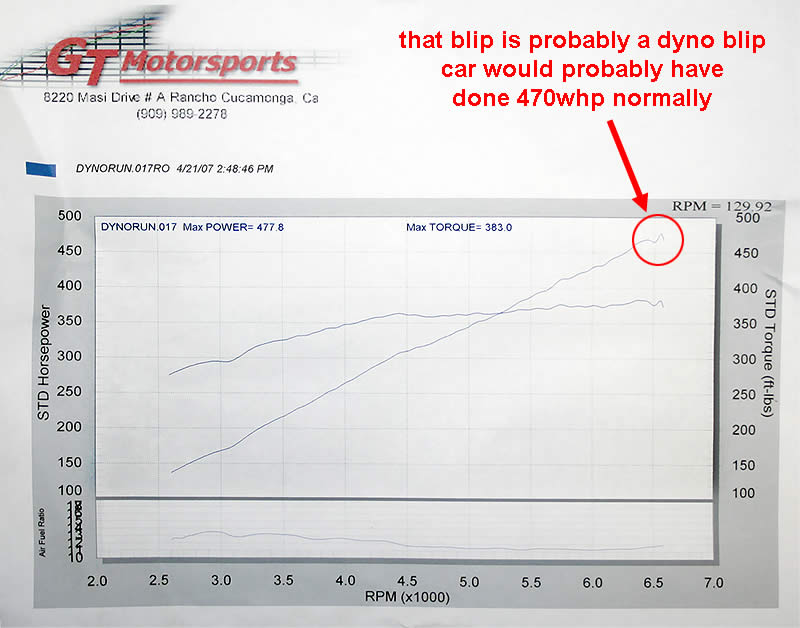

let me bring a few things up
- I do have JWT S1 cams
- I am driving on 295 R-compound tires
- My intake temps are 40 degrees from water/meth injection and so lots of timing was added
even Booger can attest to how much timing has an effect on power since he had to pull 13 degrees timing on his 21.7 psi @6690 rpms dyno run making 383-389whp. If he didn't pull so much timing, he probably would have made a lot more power but probably hurt his engine due to the SS box's limitations with not being able to add the needed fuel beyond a pressure of 16 psi. Instead of pulling timing, I'm adding timing since I also run race gas in addition to water/meth injection and have a way to monitor intake temps via the Fcon
- psi means absolute dick on a supercharged car as far as power goes. What matters is airflow and power. There's lots of ways to make power, but the pressure in the manifold doesn't absolutely reflect final power you make. If I was driving a 7 liter Z06 engine with a big exhaust, my psi would be 5-6 psi even though the vortech would be blowing the same amount of air into the engine. Booger for instance made 383whp at 21.7psi, but there's a lot of other things going on besides just the air pressure.
On a street car that's supposed to last more than a year, IMO you actually don't want the pressure to be super high because that means there's that much more pressure on the internals and that much more likely the spark will get blown out. Pulling lots of timing also raises EGT's and reduces gas mileage, but doesn't put as much pressure in the cylinder during the instant of ignition
Even on turbo cars there's a lot of variance with power and psi due to how much their exhaust and engine can flow. Sharif's car is making 450whp (dyno-dynamics) at 8.3 psi on his car. Sam's car made 630whp at 12 psi. Yet there's tons of people making 400whp at 9 psi. The wastegate will still open at the designated psi, but it has no idea how much air flow volume is actually going into the engine. It's only concerned with pressure
- On my low octane map, it was reved to slightly under 6500 rpms, not 6600 rpms. Had it been reved to 6600, it would probably reach 460whp instead of 455.2whp
- On my high octane map, there's a blip at the end of the run that's possibly a dyno error. Had that blip not been there, it probably would have only done 470whp instead of 477.8whp
- Who cares about parasitic loss when you get results. Superchargers eat up some power to turn the blower, but the end resulting dyno numbers that people get still reflect how their car drives. I don't think the engine is going to melt anymore than if there was a turbo that could send the additional parasitic lost power down the driveshaft instead of into turning a blower
- There's guys on the forum with greddy TT's with 460whp and about the same amount of torque who have claimed they don't lose traction in 2nd gear due to their tire and alignment setup. Even I have stickier tires than some of them and an aftermarket LSD etc. Hell, Alberto said back when he had his 400whp turbo setup on the stock block, he had complete traction in 1st gear on his 285 KDW's. Someone explain THAT to me then why my car isn't making the power my dyno shows. We all know his 1/4 mile times so I don't think his power is put into question but consider that his 1st gear with the 3.5 FD is 47% more aggressive than my 2nd gear with 3.9 FD is...
So far I've only driven my low octane map on the street which has 370.6 tq. Even with the 3.9 final drive multiplying 2nd gear by 10.7% more than the 3.5 FD, that brings the effective torque up to 410.2tq compared to the 3.5 FD. My car is more powerful than when I dynoed it at dynocomp. I could feel that it's more powerful. It's hotter outside now by 20 degrees than when I last dynoed at dynoocmp. Sam's before/after dyno shows what he did, I posted a video (http://www.youtube.com/watch?v=wPl_QWJywL4) showing I have traction in 2nd gear, and suddenly people claim my car must not be as strong as it because my R-compound tires just so happen to grip the road in 2nd gear onward. What power/tq level are they thinking I must actually be at then? What if I put on some bigger/stickier 315/35/18 Kumho V710 and got full traction even in 1st gear? Traction is a key issue with me because without it, all the power in the world is useless if you can't use it
there's been lots of vortech people with +450whp
no one claimed BS when AAM tuned DB350z3469's vortech to 460whp 380tq @ 10-11 psi on their dynojet
https://my350z.com/forum/showthread....ht=vortech+AAM
No one claimed BS when Lou posted 470whp 378tq on his vortech @10psi
(he had test pipes though, vs my 2.5 inch AAM cats and dual 2.5 inch exhaust)
https://my350z.com/forum/forced-induction/142771-who-says-vortech-can-t-make-big-power-part-2-a.html
btw on page 3 Lou says someone named John made 505whp with a vortech and intercooler chiller, but I think some of that power was nitrous going into the intake
CP RACING has tuned vortechs past 450whp on their dyno-dynamics dyno. Here's mcduck's 451whp car at 9-9.5 psi:
https://my350z.com/forum/forced-induction/147093-vortech-low-torque-riiiiight-451hp-368tq-dynos-inside.html
-they didn't have a standalone
-they didn't have water/meth injection and race gas
so why am I such a different case?
I plan to dyno my car on Dynocomp's dyno-dynamics dyno which I've been using all along as soon as I fix my worn bearing
in the meantime, how come GTM's other dynos have never been brought into question?
When George@GTM did 518whp on the APS TT, how come no one called BS on his dyno from the same place.
When Nitrouz and Sam posted dynos over 850whp, how come no one said they were BS?
Attached Thumbnails New vortech dyno charts at GTM 477.8 whp 383 tq-91octane.jpg   New vortech dyno charts at GTM 477.8 whp 383 tq-96octane.jpg   New vortech dyno charts at GTM 477.8 whp 383 tq-low_vs_high_octane_maps.jpg

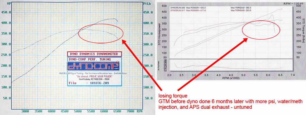

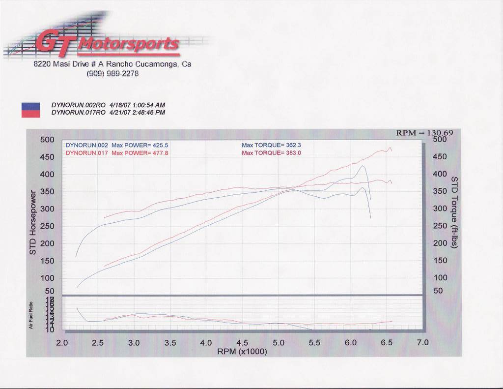

sorry, i don't always remember to update every single thread I have or all the signatures I have on every forum I'm a member of - which is like 15 forums

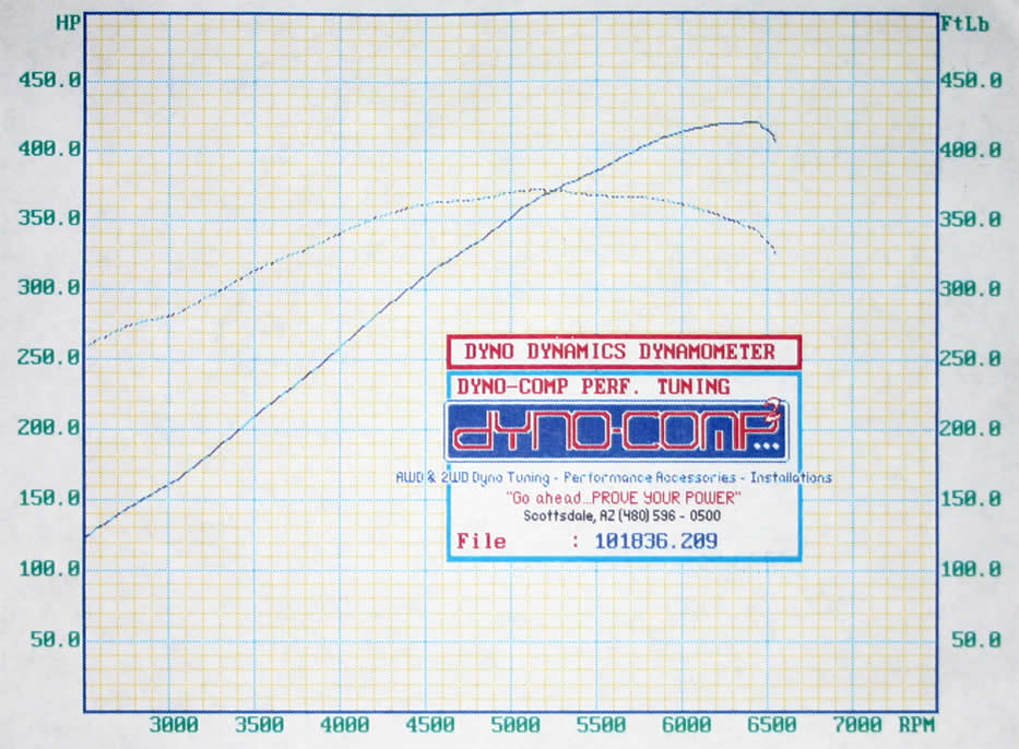

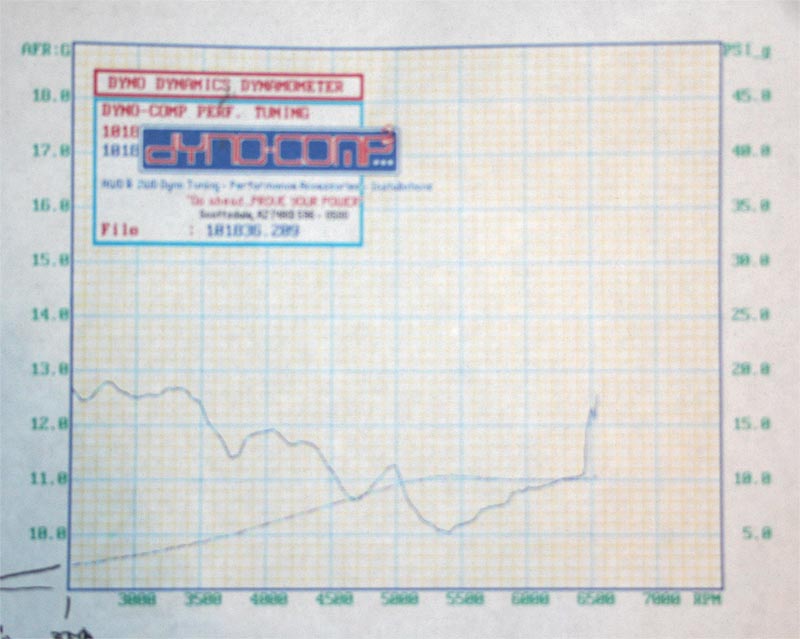

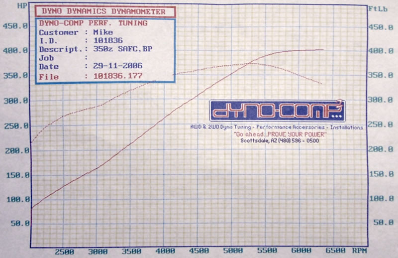

here's my dyno from december 8 (1st and 2nd graphs, dyno 209) and then one from november 29 (3rd graph, dyno 177 before I was tuned).
I never bothered to keep a dyno from last march because it was pretty similar to the december map - was actually making slightly less power up to 4000-4500 rpms or so. Bear in mind I just switched my exhaust from nismo to APS so that was probably shifting the powerband to favor the high end more at the expense of the low end. It wasn't as cold as December though. I actually remember shivering in the shop it was so cold standing near the fans blowing on you.
I will be comparing my new dyno to the march dyno BTW since it is the most recent dyno I have at dynocomp and reflects what GTM was dealing with when the car arrived there
Dynocomp always dynoed in 4th gear.
GTM dynos in 4th gear most of the time except does 5th gear on the last few runs to fine tune things and get a more accurate reading. Sam claims 5th gear pulls have shown slightly better numbers on his dyno than in 4th gear - the before dyno Sam poosted was done in 4th gear
On dyno 209 (december 8, first 2 graphs) the boost went to about 10.3 at 5400 rpms, then fell down to 10 by 6000 and stayed at 10psi until redline. My boost pressure no longer drops like that since my belt doesn't slip anymore, which is another major reason my torque curves started dropping on the dynocomp graphs. Also look at my A/F, it's hardly optimal and too rich up top, but it was the best that could be done on my car given how little control we had at that time
In March the belt slip issue was fixed but the fuel pressure issue became so severe when the boost would increase (in that case was about 12 psi as read on dynocomp's dyno) that the power would fall on its face once you reached 5500-5900 rpms. Fuel pressure at redline was 20-25psi and there was just no way to continue or attempt to tune without first fixing the fuel pressure issue.
But as you can see in my GTM chart, my tq curve doesn't drop off anymore since the fuel pressure issue was fixed. The GTM A/F curve also stays nice and flat, where the previous dynocomp runs would start to lean out from 5400 rpms upward because there was nothing that could be done to fix it without fixing the fuel pressure issue
4th dyno is the before/after dyno at GTM
...and what do you know, the before dyno on the GTM dynojet and the december Dynocomp dyno both start dropping power past 5200 rpms...(see last graph image) the slight wavy variation is because I did change my exhaust, add water/meth injection, and had more psi and we couldn't tune it because everything was inconsistent. We couldn't tune a moving target.
Sam already explained how that spike you see on GTM's before dyno was a dyno spike that didn't show up on his other before dyno in 3rd gear
Attached Thumbnails New vortech dyno charts at GTM 477.8 whp 383 tq-sentry65_vortech.jpg   New vortech dyno charts at GTM 477.8 whp 383 tq-af_boost.jpg   New vortech dyno charts at GTM 477.8 whp 383 tq-safcii_vortech_dyno.jpg   New vortech dyno charts at GTM 477.8 whp 383 tq-sentry0001.jpg   New vortech dyno charts at GTM 477.8 whp 383 tq-compare.jpg
