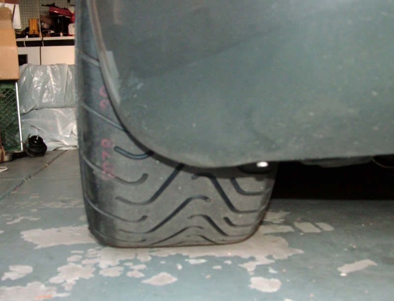

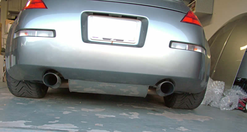

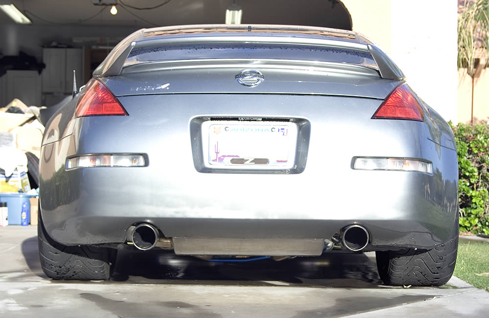

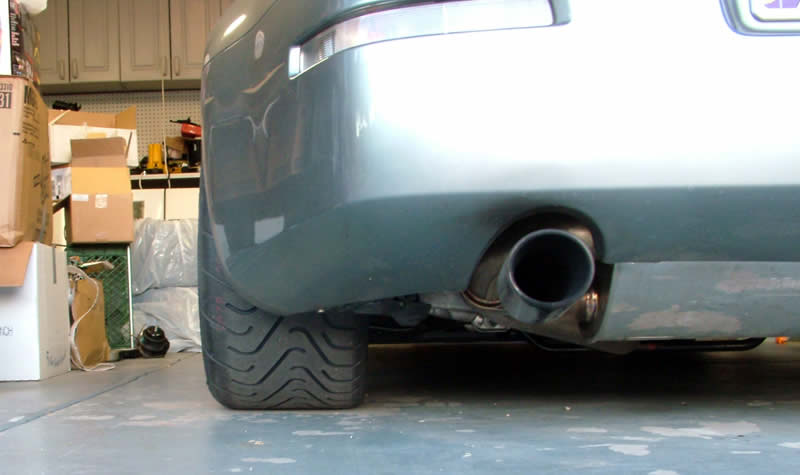

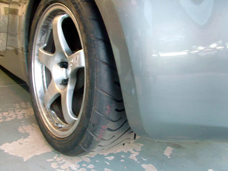

Earlier I mentioned that I have an appointment scheduled for a dyno run at Dynocomp next wed morning which is the local shop I've been using for the last year and a half. That was the earliest they could fit me in. It's about 15 or so degrees warmer now than it was when I last dynoed two months ago in feb, but I think I should still hit around 440-450whp on their dyno with my 96 octane map.
Rich, the tuner at Dynocomp and me have always thought my car should reach 440-450whp on their dyno if if I didn't have my fuel pressure issues. I actually hit 430 at one time when the engine was cooled off and the car ran something like a full point too lean (like 12.5-13 A/F or so) but was ok because I was running half race gas. AAM's timing map on their ECU flash I don't think was nearly as aggressive as the timing maps that Sam@GTM tuned my car for with water injection etc. The thing that's up in the air is I did 380whp on Sam's dyno and at two different times (dec and feb) hit 420whp on dynocomp's dyno with the same setup before GTM worked on my car. So I dunno...
I did several 2nd gear pulls to redline yesterday and it was very sure-footed and hooked everytime. I actually felt like if I had more power or an even a slightly shorter gear ratio, that it would still hook
I think the main reasons it's getting full traction in 2nd are due to my nismo LSD, 295 wide competition tires, -1.6 degree rear camber, as well as the gradual torque curve of the SC
I only tried 1st gear once, and that was because it was obvious it wasn't going to hook at full throttle, even though it was completely controllable and stable when it lost traction. It's possible if I did a burn out and/or lowered my tire pressure to more like 30 psi (I keep my rears at 34-35 psi cold right now) that 1st gear might possibly hook, but who knows. People always talk about their car going sideways or fishtailing, but mine doesn't do that. I've done everything in my power to keep it from having any sudden loss of control. I have VDC permanently disabled via the fuse plug behind the shifter and Sam called me about that asking if I was ok with that and that I would also lose cruise control with the Fcon unless I wanted everything wired up a different way which had some other compromises and would take a little longer. I never use cruise control and hate traction control so that's how Sam wired it up
I could be wrong, but I think Alberto once said he had full traction in 1st gear with his 400whp TN ST setup with 285/35/19 KDW2 tires. Otherwise before I started going FI, I was assuming 1st gear being a 3.794 gear ratio would be way too aggressive to hold traction no matter what final drive you could put on it (that's available) and you'd have to either back off the throttle or short shift anyway. Knowing the vortech powerband, I figured I wanted to get the revs up ASAP so I could shift into 2nd gear sooner and the 3.9 FD would do that the best
a few months ago in December when it was 60 degrees outside I lost traction in 2nd gear somewhere around 5500 rpms. This was when my camber was -3 on my rear left tire, and -3.5 on my rear right tire. Not sure how one side got so far out of spec, maybe I hit something. This was before my alignment with needing SPC toe bolts to get the right rear tire in spec and also before I had the solid diff mounts and JIC camber and traction rods installed. The car REALLY felt MUCH more planted after that. Of course it's not 60 degrees outside anymore either so who knows
After I use up this tank of gas, I'll put in all race gas and try my 96 octane map and see if I get traction in 2nd. Maybe I'll make a video if the footage turns out ok. My tires don't chirp when I shift gears either, they just grab
(these attached pictures are older ones from last june when my rear camber was way out of spec)
