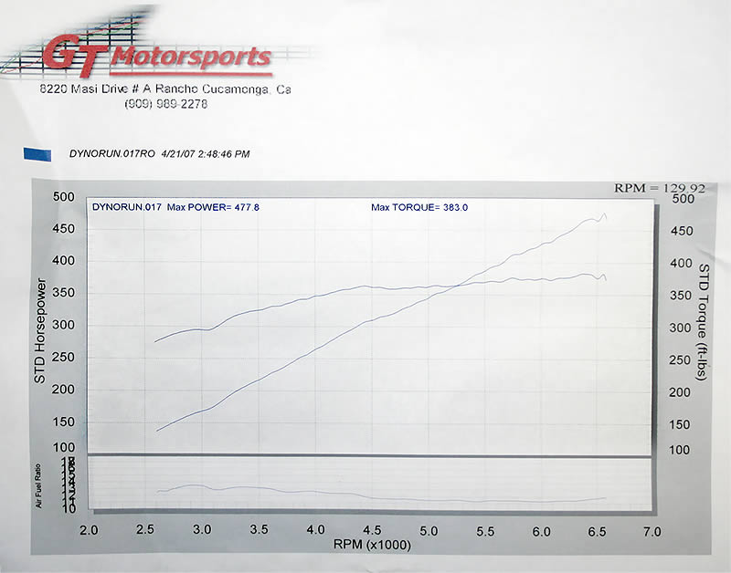

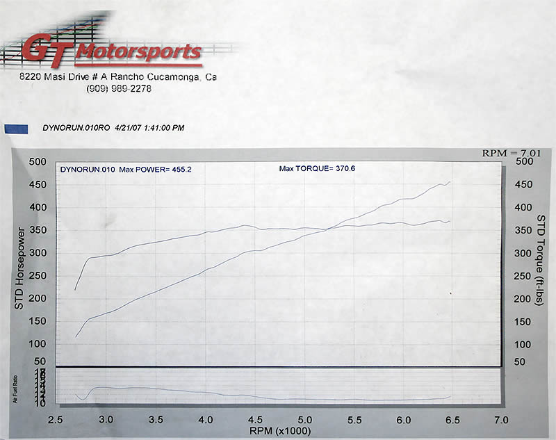

At last I finally made it to GTM to have the Fcon V-pro installed and get my fuel pressure issue fixed. The results speak for themselves. There’s two maps, one for 91 octane, and one for 96 octane. However I’m still going to run 5 octane higher gas on each map just for added safety because I’m paranoid.
The 91 octane map came out with 455.2 whp and 370.6 tq (1st graph)
The 96 octane map came out with 477.8 whp and 383 tq (2nd graph) it'd probably be more like 470whp if it didn't have that spike at the very end
GTM uses a dynojet with STD correction, not SAE correction. So it would probably be read less with SAE numbers, but on that day with the 62 degree high (rained the day before), that's what the car made on that dyno

The graphs do basically what I've been saying all along what I thought my car would do on a normal dynojet with proper fuel pressure so to all the people who doubted me saying so

nice numbers. what is the boost pressure for boths maps?

thanks
boost was reading 10.9-11 psi
it was around 75-80 degrees or so outside
the car was never cooled down to do a bragging rights run
the charts posted are when the engine was hot after a number of consecutive runs.

What kinda of dyno is that ? At just 11psi I would think some correction to DynoJet numbers was made . Was there ?
[the car was never cooled down to do a bragging rights run
the charts posted are when the engine was hot after a number of consecutive ]
Seems every time you post some numbers...there is an excuse and you think it could have made more . 11psi ...thats some big numbers for 11psi .

Oh..with the car hot , the belts shouldnt have been slipping much due to your belt re-routing . I thought you said it made 12psi after the belt fix ?

I see that you stopped at 6500rpm's . Why not go to redline ? SCer make power all the way to redline and you could have made more .

i wonder why you did stop at 6500?? nice numbers though sentry.

at dynocomp in AZ the boost pressure logged there was 12 psi at redline
in CA on GT Motorsports dynojet, it made 10.9-11psi according to Sam. The only change is I put in the X pipe on my APS exhaust since my car was last on the dyno at dynocomp where it made "12 psi"
I don't think my belt was slipping. Sam showed me the boost curve on his laptop as it was logged from the Fcon. It didn't taper off, it continued to rise, but hit a maximum of "11 psi" - I don't know the details why, but that's what was logged. Also the tq curve doesn't start dropping at any point in the upper rpms like it did in all my previous dynos when the belt would slip
I was talking with a guy there who was running the 3.12 pulley and he said he was getting 9 psi - but of course a little different exhaust/engine setup than mine. AZ's elevation is 1250 ft and Ontario, CA's elevation I think is around 950 ft. If true, I'd think the boost pressure would be higher at GTM than in AZ, but I dunno. The numbers were logged as they were
My redline is 6600 rpms. I'm not reving beyond that at this power level on a stock bottom end with stock valve springs. It would continue to make power beyond 6600 rpms, but I want the engine to live awhile longer. Dynocomp took it to 7000 a few times, but Sam wasn't recommending it
I don't think Sam fudges his dyno numbers. I think most people are in agreement they're a reputable shop with a reputable tuner and a consistent dyno. I'll call Sam and ask him if the numbers were SAE, STD, or uncorrected. I've been to two shops now where my torque was above 370. My gut reaction is maybe it's true. I didn't think I posted any excuses why I didn't make more. I said I could have done a "fake" dyno run where the engine is cooled off just for the sake of bragging or waited until it was colder outside, but I see those as BS runs not really like how the car really would be in the real world so I chose not to do any of that. It'd just be a number anyway, not like my car would permanently gain that power

Something else struck me . You said you did a before dyno and got several 380whp runs...then you said it was up to 420whp . How does one gain 40wp on just doing dyno runs back to back ? Then by tuning alone , you gained another 57whp ? Wasnt your original posted number on My350 at 430whp and on G35Driver 435whp , but a before dyno at GTM shows up at 380whp . What gives with that ?

WOW, VERY impressive Sentry, that powerband is the best S/C powerband Ive seen. Id love to see you run your car at sea level you would go well into the 11's with a good launch. Love how that TQ curve doesnt fall off, and how the power just keeps climbing, very nice.

very nice!! i am extremely pleased to hear that your fuel issues are finally resolved. the powerband looks great and smooth.

superb power band...very nice. She was making power all the way to redline.
