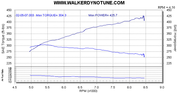

At last I finally made it to GTM to have the Fcon V-pro installed and get my fuel pressure issue fixed. The results speak for themselves. There’s two maps, one for 91 octane, and one for 96 octane. However I’m still going to run 5 octane higher gas on each map just for added safety because I’m paranoid.
The 91 octane map came out with 455.2 whp and 370.6 tq (1st graph)
The 96 octane map came out with 477.8 whp and 383 tq (2nd graph)
GTM uses a dynojet
I might throw my car on dynocomp's dyno (dyno dynamics) since I've always used their dyno and am curious what their dyno shows

Sam at GTM and really everyone there are just awesome. I have nothing but tremendous things to say about them and their shop and level of detail they spend on your car and keeping in touch with you about how things are going. The shop is absolutely huge and easily the most impressive shop I’ve ever seen and likely ever will because of the sheer size of it and amount of equipment they have. Sam showed me all sorts of things they’ve been working on and I won’t steel his thunder, but he has some neat parts coming available soon.
There’s just so many things that seemed beyond what a normal shop would do. He measured A/F directly from the cats instead of the exhaust when on the dyno. After tuning my car, we went out and tuned it on the street for awhile, came back and he tweaked it some more. Then let it sit idle so it’d heat soak, and tweaked it some more, then street tuned it even more. The level of care he takes with the Fcon is impressive to me. I know a full standalone needs a lot more detail than a normal piggyback, but I was extremely happy about his personal mission to get everything as perfect as it possibly could.
As far as the Fcon itself – it’s obviously a major improvement. It’s very smooth. Before I sometimes felt the powerband would have little lumps at as revs went up or slight lumps in power as the throttle position changed, but not anymore with the Fcon. It's very smooth and feels great. It’s by far not a cheap investment, but probably well worth it in the end. I had a knock amp installed, EGT compensation, air temp sensor, and Navigator monitor as well as all the other standard Fcon things included in the Fcon special they’re still currently running.
My fuel pressure issue has been fixed. The culprit was my pump assembly. One of the fittings was loose, one of the hoses they said was collapsed or something along those lines to block flow, it possibly wasn’t drilled with the right size, and the cloth sack thing (don’t know its proper name) was all messed up and broken/deflated – they said it was bent or whatever. Anyway I got a completely new pump assembly and they started from scratch also including a brand new walbro pump. The CJM stage 2 hard line was also installed.
That’s about it. The car is faster. I can feel just from driving it, that it gained some power. He did do a dyno run of my car as it was when I drove in to his shop and said on his dyno it did several 380whp runs initially and then it somehow was able to do a couple 400-420whp runs. I haven’t seen those graphs though yet as we both totally forgot about them and I don’t know how much torque they made earlier in the powerband.
Either way I can finally drive the car fully all the way to redline and it drives better and smoother than it’s ever driven before. Sam and everything about GT Motorsports was great – everything was finished a day late, but I know how these sorts of things go so I wasn’t too shocked by that and Sam made up for it anyway (I was staying in CA with my wife for a few days and we needed to get back). I mainly was concerned with the results and I got exactly what I was expected from them which was a great tune, a fixed car, and a great overall experience
BTW from the street tuning session Sam and I did on the car, I had complete traction in 2nd gear and onward. I haven't tried redlining 1st gear yet though, but it's probably too short to maintain WOT traction.

The graphs do basically what I've been saying all along what I thought my car would do on a dynojet with proper fuel pressure so
to all the people who doubted me saying so

Sentry said you did a before pull and came up with 380wp and did some more and got 420whp . Could you tell us more of what was going on ? Kinda strange...he comes in the door with 380whp and out the door with 97whp more with just tuning . He was tuned by another shop to 430whp . You wouldnt think there was 47whp more left in it to tune .
Awesome numbers! I'm glad the car didn't bend a rod on the dyno with that much power. Wonder if the s/c powerband has anything to do with that? Anyway, glad to see high numbers on the Vortech!
