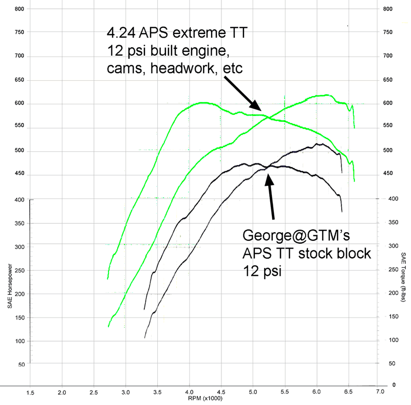

12 psi 3.5L vs 12 psi 4.24L
makes about 100 whp/tq difference across the entire powerband for the 4.24 stroker, extreme headwork and cams
of course this dyno has the regular and extreme APS turbo kits so the extreme kit has bigger turbos which will have less low end power and more upper power

Its still not determined if the stroker is making more power/ that a non stoked motor with the same mods. Your not going to gain, anymore power just becuase you strap on a stroker. Yes torque would be increased, but that doesnt necessarily mean hp will also.
The graph shows a fully built head+aps extreme turbo kit vs a stock motor regular aps extreme kit. Granted there is a 100 hp difference, but if you were to port and polish the heads, cams and valve train work in addition to the larger extreme kit, I think it could easily make the same hp/ pound of boost as the stroker.
bigger engines are not as efficient at high revs, but headwork helps even out that flaw.
6500-7000 rpms really isn't that high of a rev anyway
I dunno though, bigger engines make more power. It's a classic power gainer mod
no replacment for displacement, yada yada yada

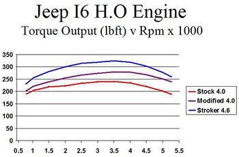

well it remains to be seen then what'll happen on the VQ with it then. I agree with that the lower rpms see the most benefit with a stroker kit.
IMO I still think at 6500-7000 rpms the upper rpms might still benefit a little, especially if FI is involved. Headwork increases power across the board, but sees the highest benefit in the upper rpms compared to the lower rpms.
I've seen before/after dynos with stroker kits by themselves that don't rev to 9k rpms - like jeeps where they rev to 5500 rpms as well as other dynos of cars with FI like talons, EVO's, and mustangs, and they gained power across the entire band except it wasn't as great of a gain in the upper rpms

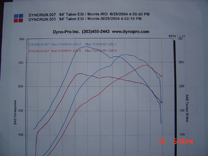

I've seen before/after dynos with stroker kits by themselves that don't rev to 9k rpms - like jeeps where they rev to 5500 rpms, and they gained power across the entire band except it wasn't as great of a gain in the upper rpms
