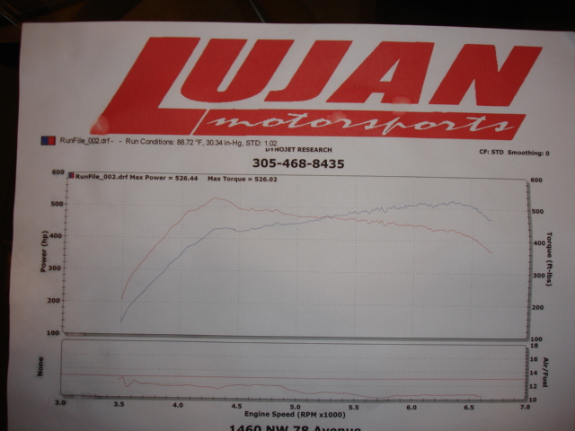

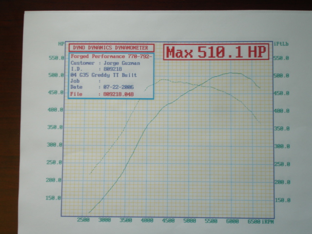

Yes the car is running fine now. The idle is steady and the car does not run as rich as before.
the first dyno was the last dyno done on a DJ a few months after Sam fixed the car. The second dyno was Sharif's dyno with no correction. I only picked up 15whp going from the heart breaker dyno to a dyno jet. Maybe cause of the difference in weather or elevation between Miami and ATL I didn't pick up that much. I don't know, but I am happy with the car other than I want more power which I plan on getting real soon.
Attached Thumbnails My SGP experience-dyno-jet-graph-001.jpg   My SGP experience-gtm-tune-hp-tq.jpg

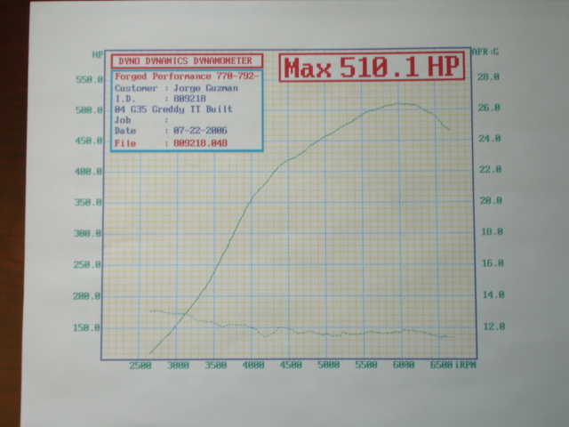

Here is the a/f on Sharif's dyno. The car is running a little richer in Miami.
