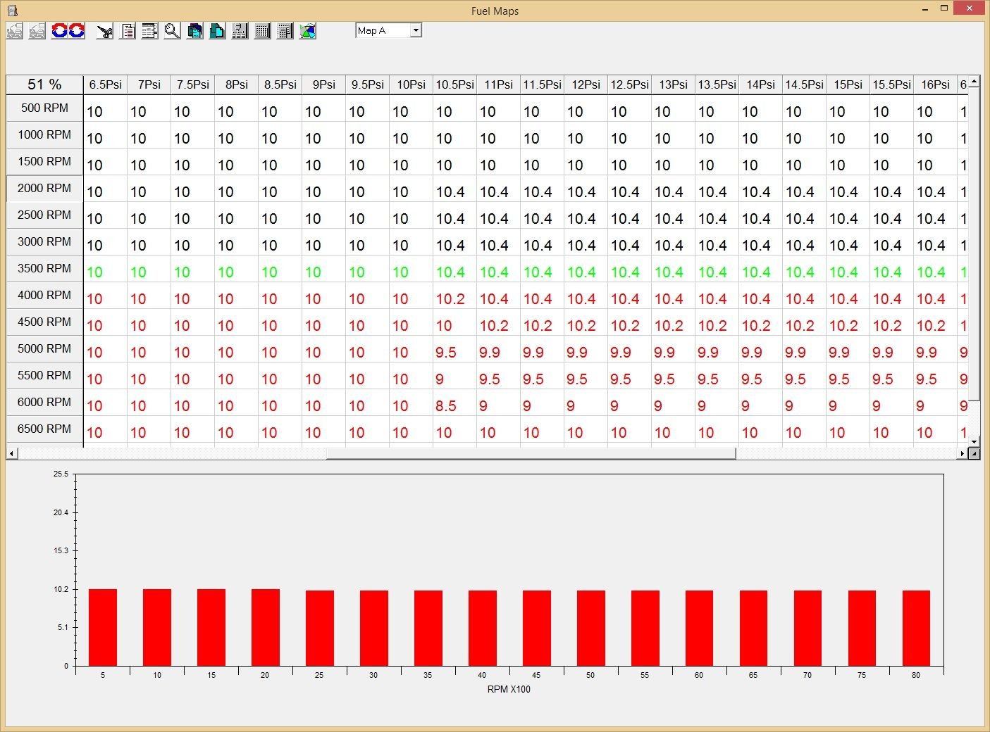

ok now messing with R4 tuning on the SS box
im looking at the base maps from Vortech
Map A - Fuel - SS is adding fuel in non boosted low RPM cells
I suspect its because vacuum on the FMU is dropping fuel pressure
and adding again up higher, for some reason in boost, where the base kit wont use it
[Map B - timing - it seems that there isn't any timing pulled by SS till 8.5 psi at 5000
am I reading these correctly ?
I suspect you're right. Adding fuel above where most users would push the kit is likely a safety measure, since Paris Hilton maps (rich and retarded) tend to be safer than the alternative, though too rich can still induce detonation.
What's interesting to me is that it doesn't pull timing based on boost level but by one level across the board. I know the VQ is pretty detonation resistant (at least in my experience), but I wonder how these numbers look relative to MBT. Maybe someone who's had the SS box tuned on a dyno could compare? Or even Tim?
Question for me is how do I translate this to an uprev timing map? Stupid burn time metric...

First of all, The SplitSecond Box TUNE that comes with the Vortech Kit is Terrible.
There will be places you need to add fuel down low in VAC. This is because the Factory tune is not perfect either.
There will be places on this Fuel Map where the Motor will never go. In that case it's easyer to make a full Row or Collum the same Value to keep the MAP simple and easyer to Read.
Vortech adds Fuel in low RPM & VAC because the is the Area of the MAP that is effected during START. Again, they spent no time and did a Terrible Job. The FMU does not reduce Fuel Pressure, it Raises it.
As you can see on the Map, most of the Values are 10 (neutral) then they made changes above 10psi where a stock Vortech kit will never be. Perhaps they were trying to cover the *** for people that install smaller serp pulleys.
They did a Worse Job with the Timing Map. The greatest change in value you should have in the Timing Map is .5* from Cell to Cell.
Do not use this Tune. Start New maps.
Read this 10 times, it is very very helpful wen tuning with the R4 Software from Split Second.

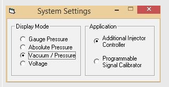

did some additional searching and found this
http://www.lextreme.com/tune.html
I opened System settings then switched display to Vacuum/Pressure since the charts didnt make sense at -5psi etc...
now the maps make more sense !!
the first set i posted were untouched from the base with the display set at Guage Pressure
glad i checked

You also need to change to "Programable Signal Calibrator"
Don't know how your base settings got messed up.
Ya, that's better. I did not know what the hell vortech was doing and did not thing to ask you about base settings.
The way that Vortech set up their Map is in Rows for the most part.
If you set up your tune in columns (by Boost) you will have mush more control over the tune.
What I mean instead of changing the row like Vortech did, change the Column, but for the most part you can change the whole column to the same Value, because the motor may only see 1 or 2 cells in that whole column.
