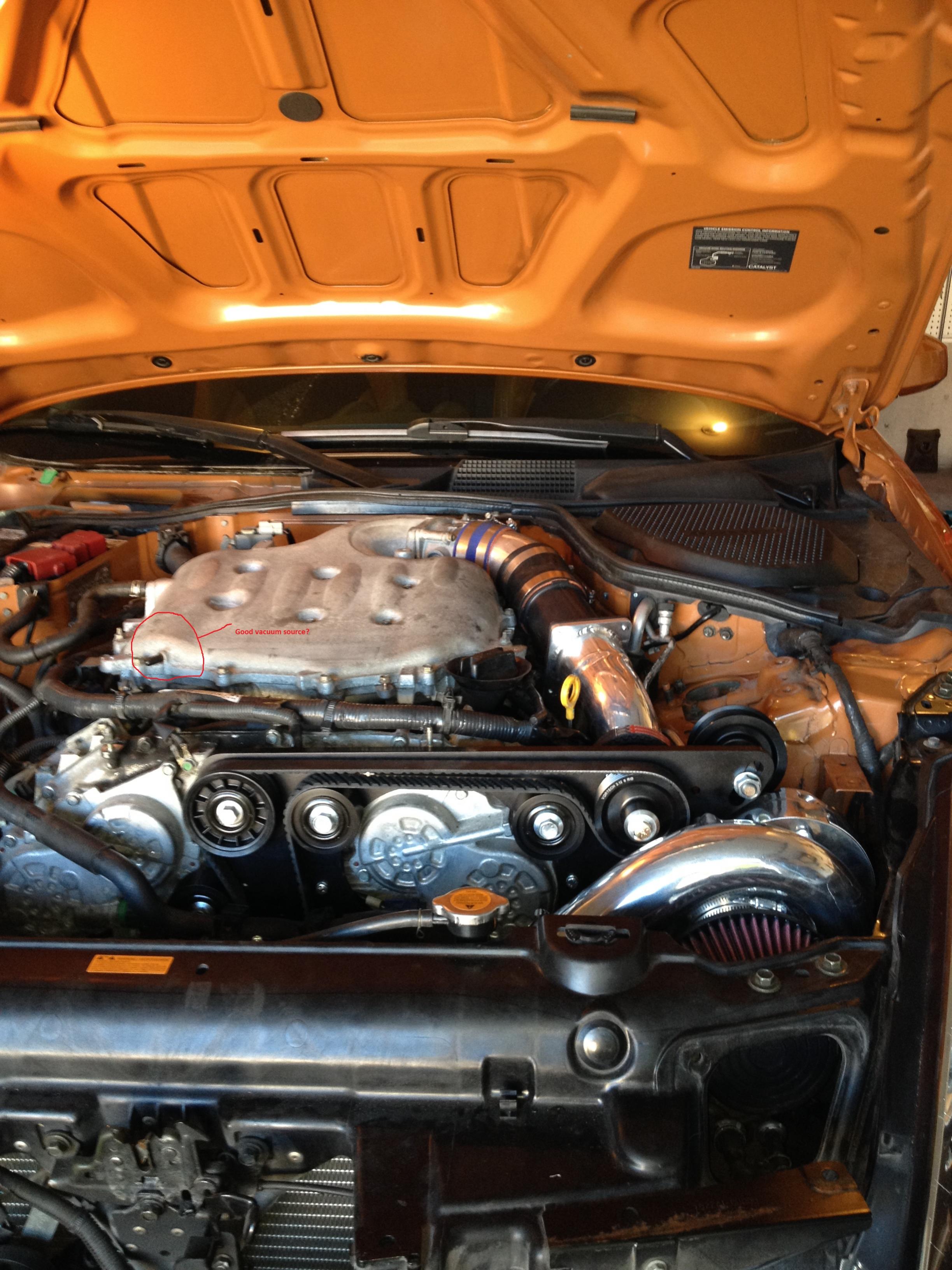

I am installing the v3 sci kit right now on my 350z but I ran into one issue I need clarification on. I bought my own fuel injectors and fuel pump so i dont have the fmu, my question is, what do I do with the 5/32 hose that hooks up to the bypass valve? It has a locknut, two washers and bolt included with it? Where do I run this?

connect it to an engine vacuum source (at the manifold, tee'd off the evap line, etc.). the BPV needs a vacuum source to tell it whether to stay open or close.

Will this be a sufficient area to put the hose? Its a nipple with a rubber cover over it that can be removed on the intake manifold.
That will work.

The nipple i have a picture of is too small for the hose I have. Theres a small hose about 8 inches long that leaves the front of the plenum on the front left side and goes to the engine cover(down by the spark plugs) to a white nipple. Would this be fine to TEE into?
