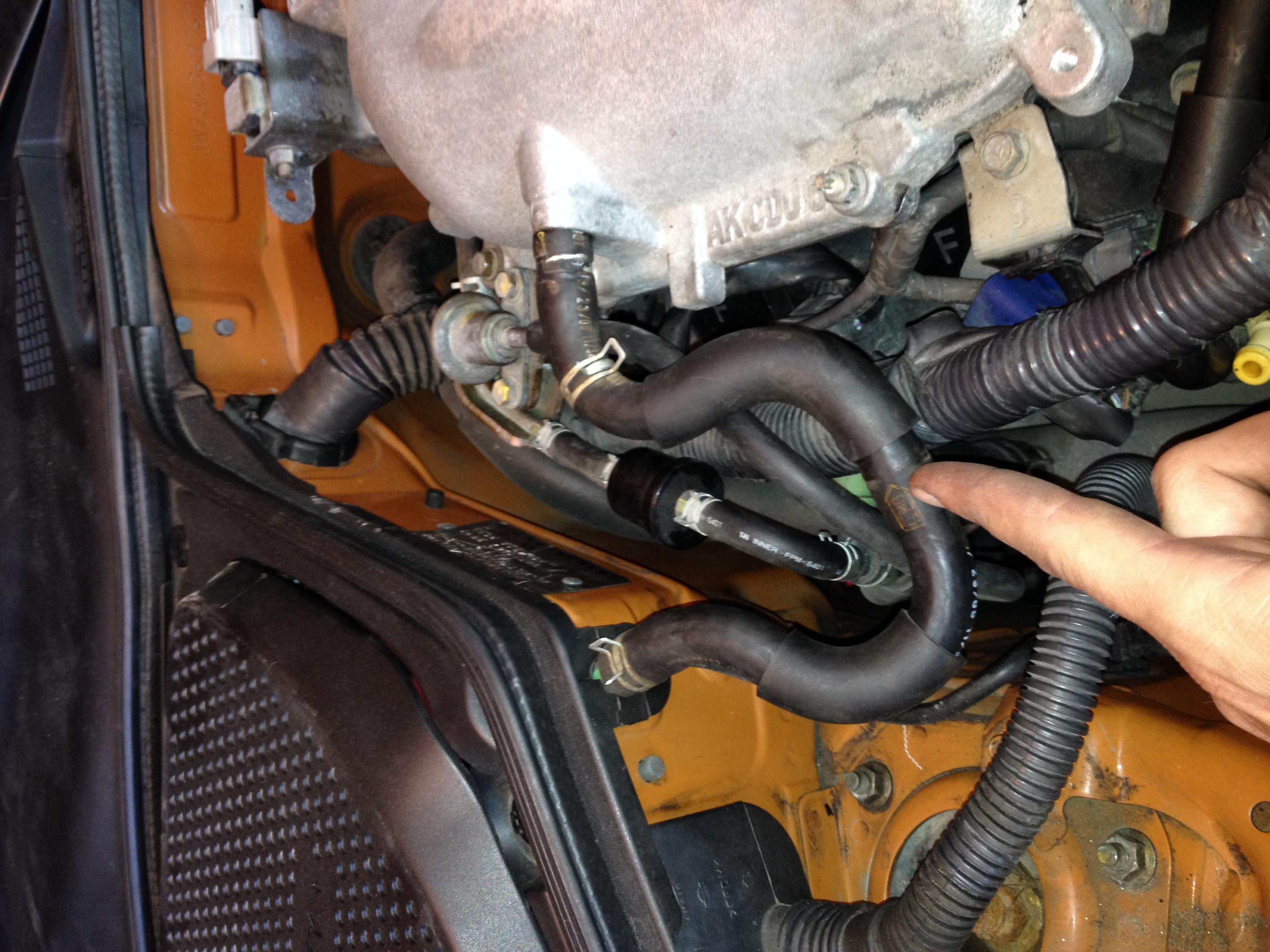

You can get smaller, vacuum hose to run to your BPV. It doesn't need to be that big.

Can i tee into this hose?

Nevermind. I hooked the bov up to the vacuum hose behind the intake manifold next the the firewall. Thanks for your help!
