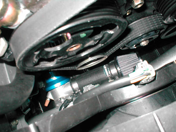

My Last issue is the BPV
the blow off sound is ok
the quiet cruise sound is ok (like inside a 747 wearing head cheap headphones)
the other sound.... the one like standing beside a 747 is driving me nuts...
did a search and found nothing definitive except for the people wanting a different but not necessarily quieter sound
what can be done to the BPV in the kit ?
has any one tried a silencer or muffler of some type ?
can it be "tuned" an adjustment or drilling additional holes ?
what straight bolt up BPV is quieter ?
bolt on... add vac hose and done
What BOV (with mods) or BPV can be used with a new flange welded on ?
Most ppl seem to like that sound... I prefer the stealth mode lol
Old Apr 18, 2015 | 07:51 AM
  #2217
OldManZ350's Avatar
OldManZ350
Posts: 2,429
Likes: 230
Yep! Mine is near dead quiet.
Buy a small K and n type Breather Filter and glue in some Black 1/4" think dence foam rubber. Added about a 6" piece of hose with a steel or aluminum hose adaptor and attach the filter......
Attached Thumbnails vortech FAQ: read this before asking vortech questions-p1010020.jpg

my BPV is totally different looking.... I heard a rumor that Vortech changed the one they put in the kit...
Ive talked to the shop that primarily sells the mustang kits.... which uses this same valve and they have had the same issue
Old Apr 20, 2015 | 10:38 AM
  #2219
OldManZ350's Avatar
OldManZ350
Posts: 2,429
Likes: 230
Same one as they always used, just a different color cover.
Bought my Vortech kit in 2003-2004 and never had any issue with the BOV.
