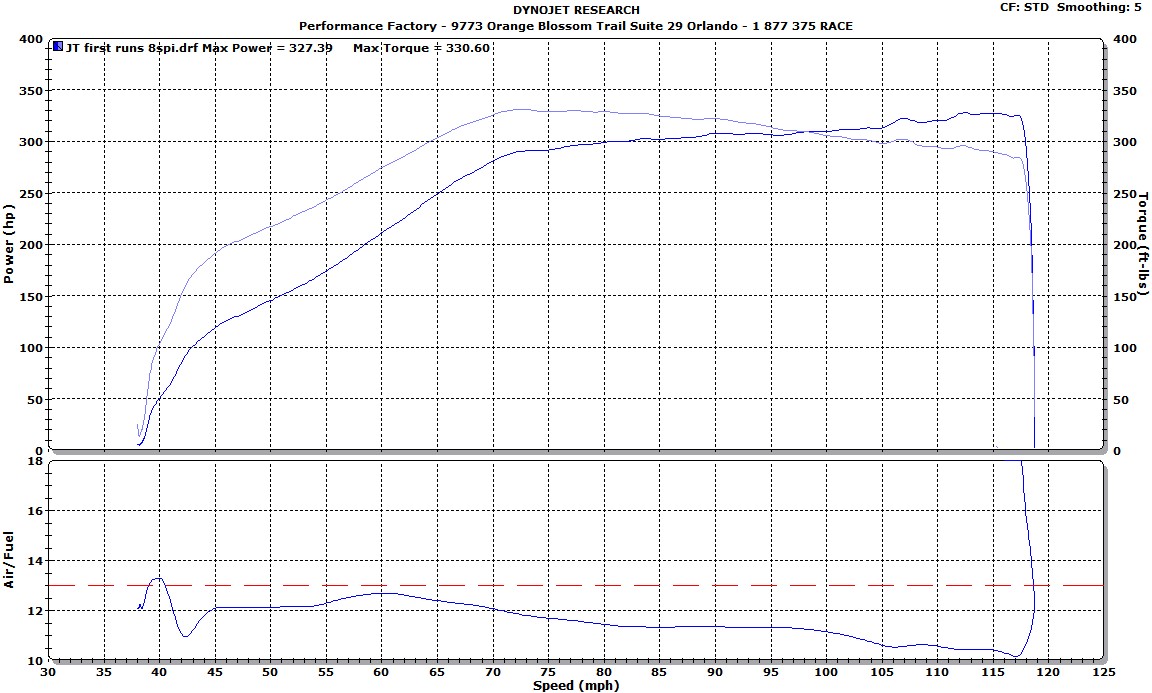

I'd love to see the dyno curve of this thing (sorry if I missed it but quickly ran through the thread)... Porting the intake manifold runners (in this case to the extreme) will help the top end power drop off common to many builds, but I'd think those big turbos would be less susceptible to that anyway. With that in mind, I would have thought long runners would help maintain the low end torque before the turbos kick in and take over. Thoughts? Nitrous shot to get into boost? So only concerned with top end?

this thing is going to HAUL a$$ for sure. remember the numbers are low because i have a turbo 400 tranny in there, also, i only got 3 pulls on the dyno before the car went in complete limp mode and wouldnt come out until i unhooked the battery for a few hours. ( very mad about that )
this is a safe 8 psi with around 14 degrees of timing in there, i always start low and work my way up, just didnt have a chance to work it up.
look at that power curve!!
we were having an issue with it picking up a rpm signal cause i had everything strapped up so tight and couldnt get to cylinder 1 at all. so thats why it is speed based.
on 93 octane and the car went 117 + mph babying it, i would say it is more around 400 whp if i was on the 6 speed at this safe level of 8psi.

Damn biotch! Now that is a MILL!
