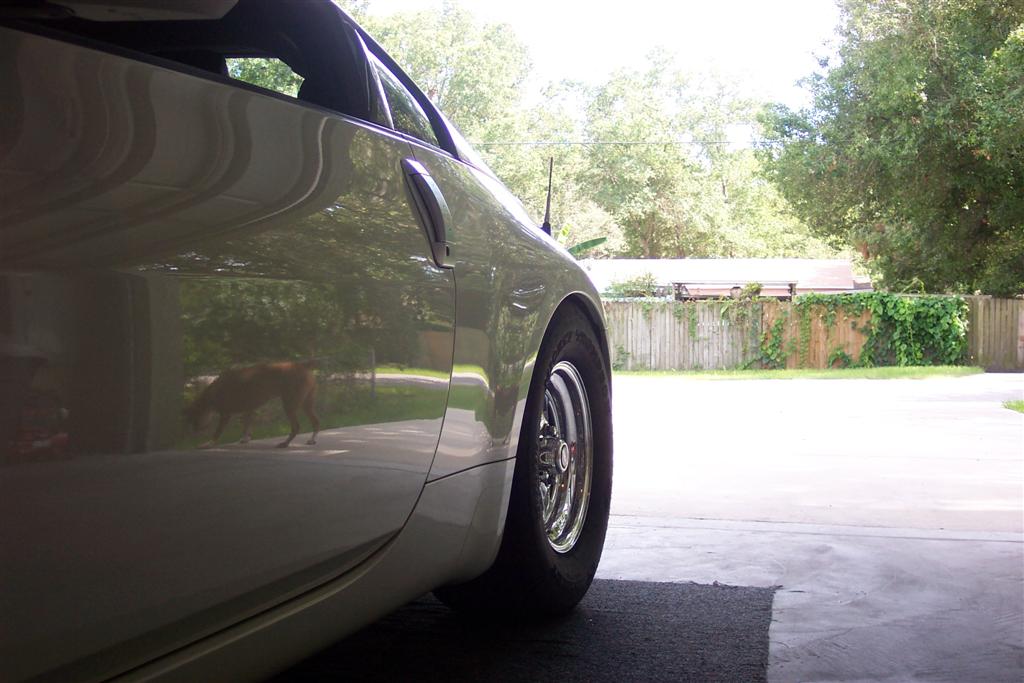

here are some pics when i took out the rear springs to check for fender clearance. like i said, i dont think the car will ever squat this far on the stock suspension... but i wanted to know that these would fit if ever ran them with my teins, or if i ever put some drag springs on. remember, this is AFTER i flared the fenders out.

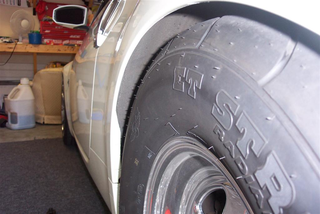

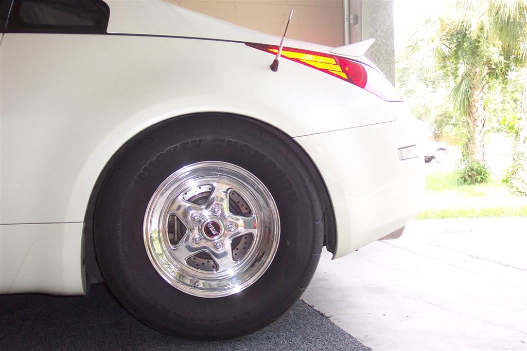

heres the specs on my drag racing brew for those of you interested in getting this tough look on your Z.
the drag tires are MT Street Radials, 26 x 11.5, 15 ". Part # 3753R.
the drag wheels are Weld Racing drag-lites. 15 x 9 w/ 5.5" backspacing (+12mm). Part # 59350.
you MUST have nismo extended 60mm wheels studs for these wheels.
you MUST have the right style lugs for this. McGuard part # 63003 is what I have.
this clears stock NONbrembo brakes perfectly.
if your ride height settings are going to tuck the tire, this setup will slam right into your fenders. remember, i flared my fenders for this. if you running stock suspension like i run when i put these on, you will most likely not have to worry about it as i dont think the rear end will ever compress far enough for them to hit. however, no promises, maybe it squats more than i realize. be ready to flare your fenders, which may require paint work if your paint cracks... i did it before painting the car so we didnt care.
