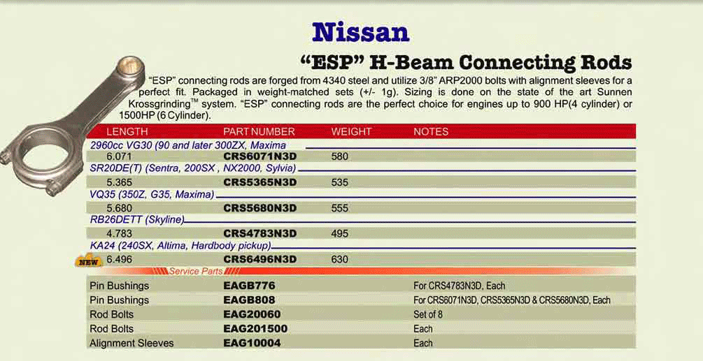

LOL. In all seriousness, 15-18 psi is the generally accepted limit for 93 octane fuel on the stock block, generating power in the hp range audible provided in his first response. Eagle H-beam rod hp rating for Nissan applications attached.
So 1500 HP?

Originally Posted by Cube
So 1500 HP?
That's what Eagle claims - I snipped that out of their web page. For domestics that envelope may have been tested. I have not heard of an aftermarket rod failure yet for the VQ35, so...
