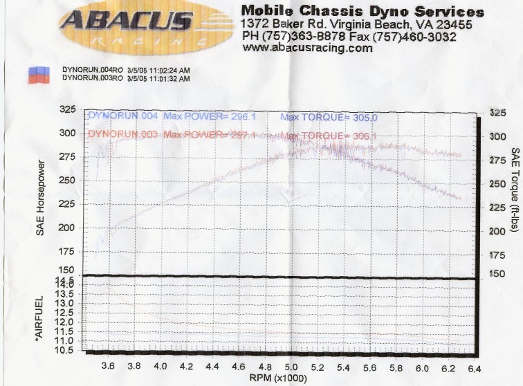

Originally Posted by Nexx
hate to say this but no it doesnt. stock C5's dyno in the 320-330 range.
Are you sure about that? This stock c5 put down 298whp.
http://www.dragtimes.com/Chevrolet-C...lip-11833.html
It's kinda hard to find stock c5 dynos, but here's a few in this link.
http://forums.corvetteforum.com/phot...59848/cat/1130
