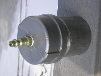

http://www.vfaq.com/mods/ICtester.html
thats how i did it but the couplers I used didnt fit over the vortech inlet so I had to disconnect the blower unit and connect it directly to the charge pipe that goes to the IC
and if you think you have a boost leak just tighten the belt a little and see if the boost is higher. Like i said it has to be really tight, alot tighter than you would think it should be

Ive been using this for a couple of years now
