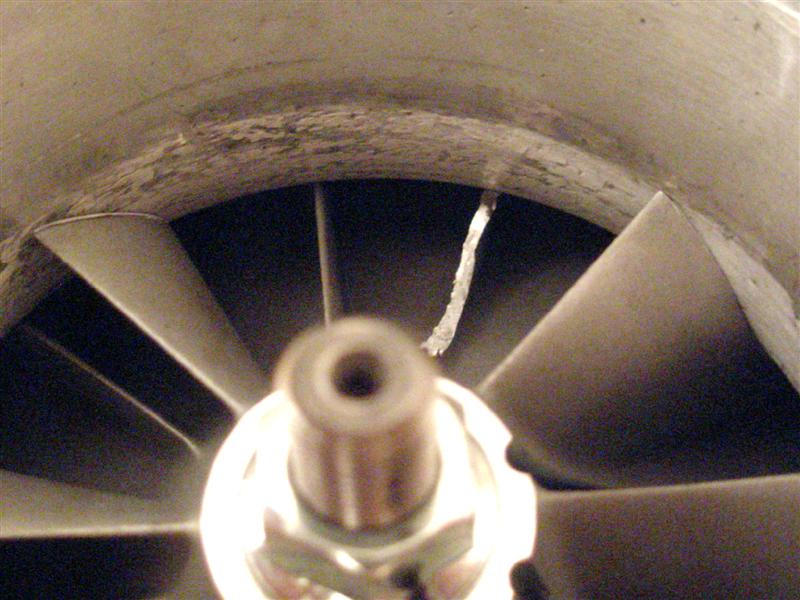

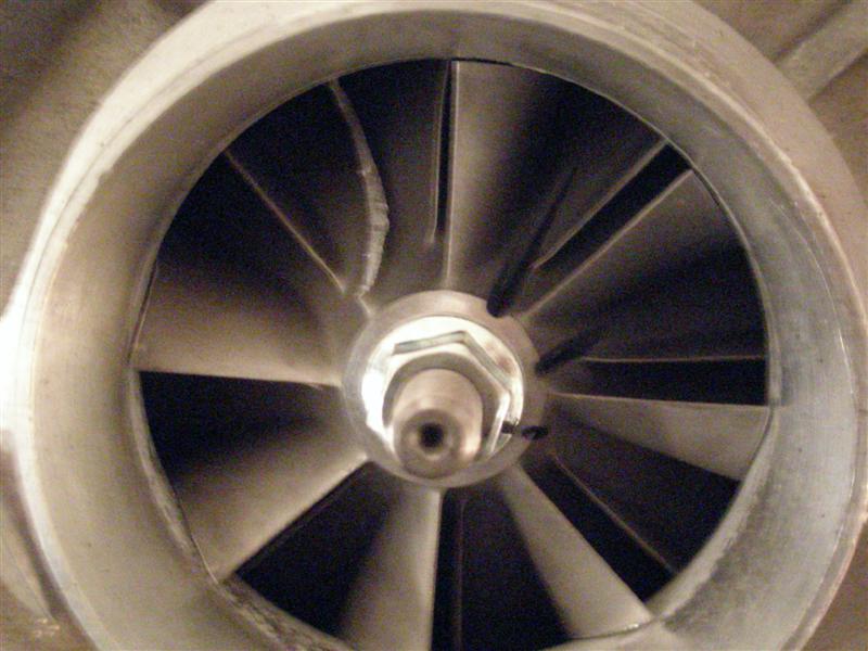

Take the air filter off and look at the impeller blades. If you see anything that looks like the photo's below....send the supercharger back to Vortech, you need the bearings replaced.
Hopefully it is just the low idle and setting it up to about 1,000 to 1,100rpm will quiet things down.

Thanks for all the input!!!! I think it may be the idle!? Because when the car at 1100 rpm it sounds ok. And I took off the filter and check the blades, they were ok too. MrJax, the damage of the blades just happen in one day or it has been awhile?
