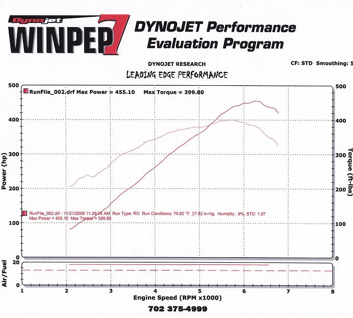

05 rev-up. original engine, non oil burning.HA,HA. been boosted for 26k miles, 26k miles on engine and z. YES IT HAS BEEN BOOSTED SINCE DAY ONE. V2 rev-up vortech s/c kit, cog pulley setup converted to non revup configuration "32/28". stillen headers, cjm RFS, rc 550 injectors, mrev-2 lower plennum, TXS U-tech ecu, technosquare "L" flash on stock ecu, dual oil coolers, fast intensions 2.5 dual exhaust, 2.5" aps test pipes 13 psi of boost at 6700rpm.
455 RWHP 400 RWTQ. tuned and only runs on 100 oct fuel. weekend driver/play toy.
Attached Thumbnails Stock Motors w/ F.I.-dynojet.jpg
