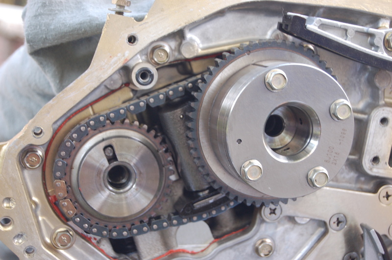

Don't forget the inner upper oil pan bolts
The 2 cam gear covers have a little o ring that fits on the inside of each cover.
Did you change/ replace those ones? You have to stretch & slide them on the shaft carefully.

INner upper oil pan bolts?
I know on the outside of the front chain cover, there are 2 special type of o ring sealers for that but thats not what im talking about.
there are 2 black small rubber o rings that go somwhere.

you know what, i gotta double check the timing cover like in the bottom diagram. that just might be it. i dont remember if i swapped those or not

Yeah, inner upper oil pan bolts. Mine were forgotten & the gasket seal blew out. I searched for weeks for this stupid leak. The oil was so clean it was nearly impossible to find where it was leaking from. With the lower oil pan off, you can look through & see where they go.
any pics of what your talking bout cuz i dont have the motor in front of me so i cant just check,

Here is a real pic of the o ring you guys are talking about from another members car.

Originally Posted by weslutes
Damn, you beat me to it
you know what, i dont think i put those in. That must be it. Ill check later.
