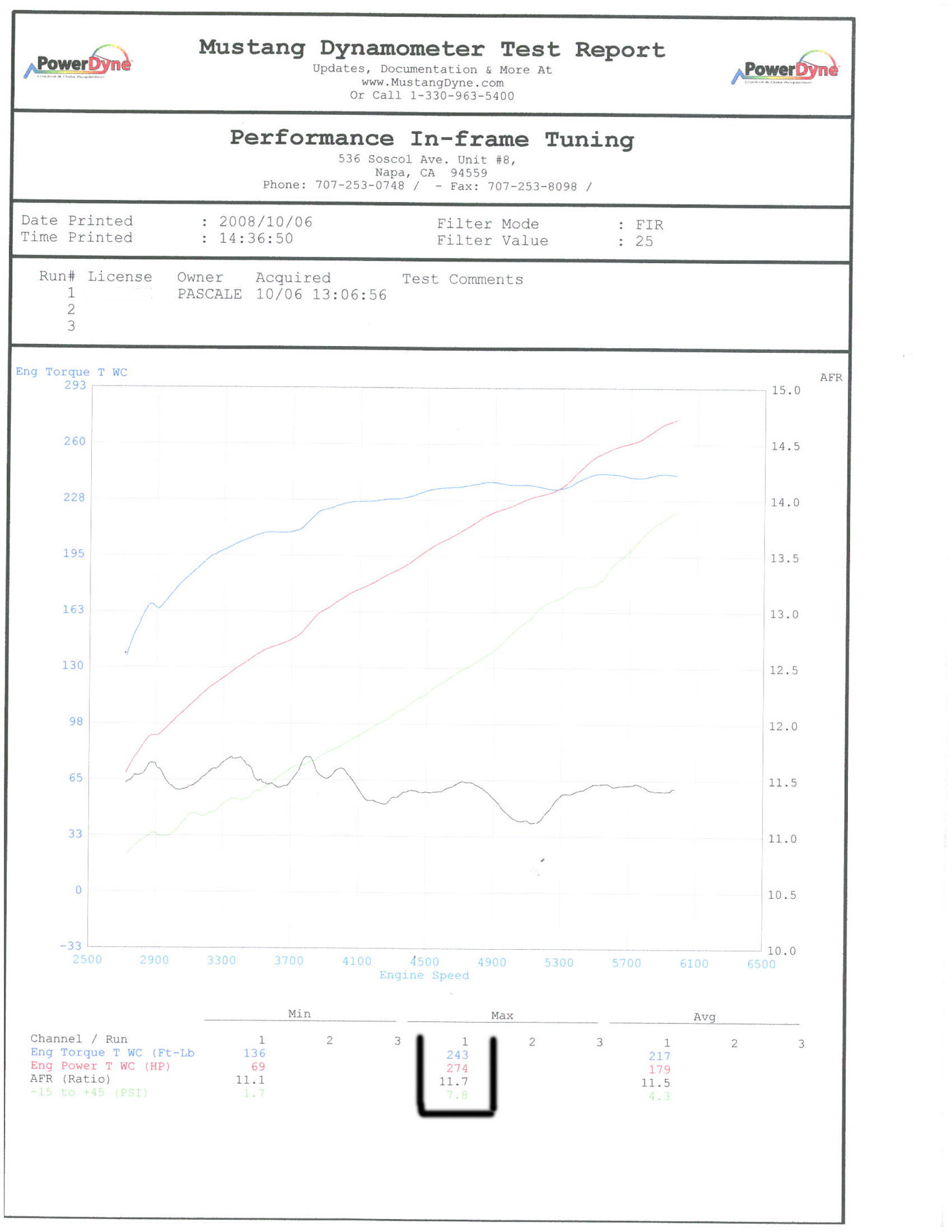

Heres the MUSTANG dyno just shy of 6k.
Thoughts?
Thoughts?

Sounds good, i'll stick to 6500rpm limit. Whats up with the 440's not hanging though? shouldnt they be enough for the 3.12?
Also, I know the dyno is 500-600rpms shy of peak and that difference is good for another psi or so but isnt the hp a little low for a 3.12? Is it the mustang dyno that read really low? shouldnt I be around 330WHP? I know dynojets and dynapacks read higher but is it rally that much difference?
A/F ok or do you think mid 12's would gain a load more?

mustang dynos do read low, but your numbers are a little bizzare. It looks like you'd hit about 303-305whp at 6600 rpms. Did you ask about what some other stock cars run like stock Z's or other similar cars so you have some base numbers or did you dyno your car initially? What are your mods? what's your peak psi?
something seems a little strange, but it's hard to troubleshoot over the internet especially if it ends up being something like the dyno not being calibrated right. Your power doesn't look like it's tapering off so it doesn't really look like you have a boost leak.
IMO 12 A/F is about as lean as you'd want to go with 91 octane. I think most tuners would shoot more for 11.5 A/F with 91 octane
Everything might be just fine and it might just be the dyno being conservative

The power deffinitley doesnt show signs of tapering off; at 6300 it went 285whp@9psi, the injectors were at 98%. On the graph above you can see that just shy of 6k PSI was at 7.8. 7.8 to 9psi in roughly 400rpm's seems like its boosting well.
My G35 was dynoed on a dynojet completley stock before I started moding, I thought I was going to have it tuned there, but plans changed. Stock was 217whp. This is an 03' G35c 5at.
The mustang dyno is less than a year old and calibrated correctly often. Like you said they are notorious for reading low. I recently dynoed another car on the same dynojet and this mustang and hp readings were between 10-12whp difference in the high 100's low 200's.
My modifications now include 3.12 vortech, 3/4 spacer, dual path exhaust, walbro 255 and the rc440's. Tuning via utec. One thing that hurts is my 19" sterns(heavier). Id consider HFC's but the car already drones now. Probably will get some berks eventually.
Where i'm really surprised is the fuel and how I need bigger than 440's. Stock injectors was maxing out at 5k on the 3.33 pulley and now 440's are maxing above 6,300 with the 3.12.
should I go with 550s or 1:1-1:2 FMU ??

is your A/F reading coming from an actual gauge or the dyno sniffer at the end of the exhaust? So it's an absolute true dual exhaust that doesn't connect at any point?
How many miles are on your engine? Have you or anyone ever tracked it, over-reved it, or "abused" it?
I'm guessing you don't know what your actual fuel pressure is right?
something just isn't adding up.
Your psi is about right.
The gas you use is just regular 91 octane with 10% ethanol right?
