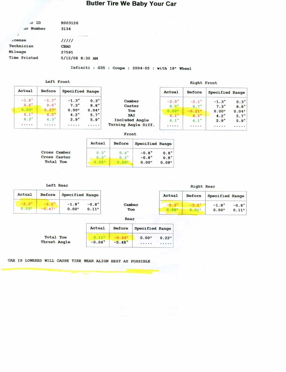

The alignment guy at Butler (in Atlanta near FP) told me that it wasn't a good idea to run less negative camber in the rear than in the front. Because my front camber was not adjustable (without new hardware), my rear camber was limited (I think it was set at -2.3, fronts set at -2.1).
EDIT: I should add that in the interim, I have done some reading, and other "experts" say that more negative camber in the front is ok to manage the dive in for turns. I decided to get SPL A arms for the front and go to my local expert and just tell him I want it to go straight.

Well I told the guy I didn't like the amount of negative camber in the rear (it was way off initially) and got the camber arms and toe bolts installed back there so I could get more traction - asked for -1.5 in the back. And then he gave me the story of why he wouldn't go beyond -2.3 and told me I needed to fix the front first. Maybe just his experience, but he does this for a living... I could have misunderstood, but I went over it carefully with him. I was talking to him the whole time he was working on the car. I did tell him I favored straight line over twisties and he gave me a little toe in in the back. He would not adjust to less camber than what you see in the attached pic despite my request to straighten out the rear.
So you dont have an adjustable arm in the front If you dont... that would explain what he means....

Well I didn't then. I've got SPL street spec arms sitting in my garage now waiting for someone to install them.
But my point was that he was unwilling to go to -1.5 in the rear while leaving the front at -2.0.
You guys are confusing me. You said you have less negative camber in the rear than the front (0 vs -1). So why was this guy complaining about a -1.5 vs -2 setup (rear vs. front)?
