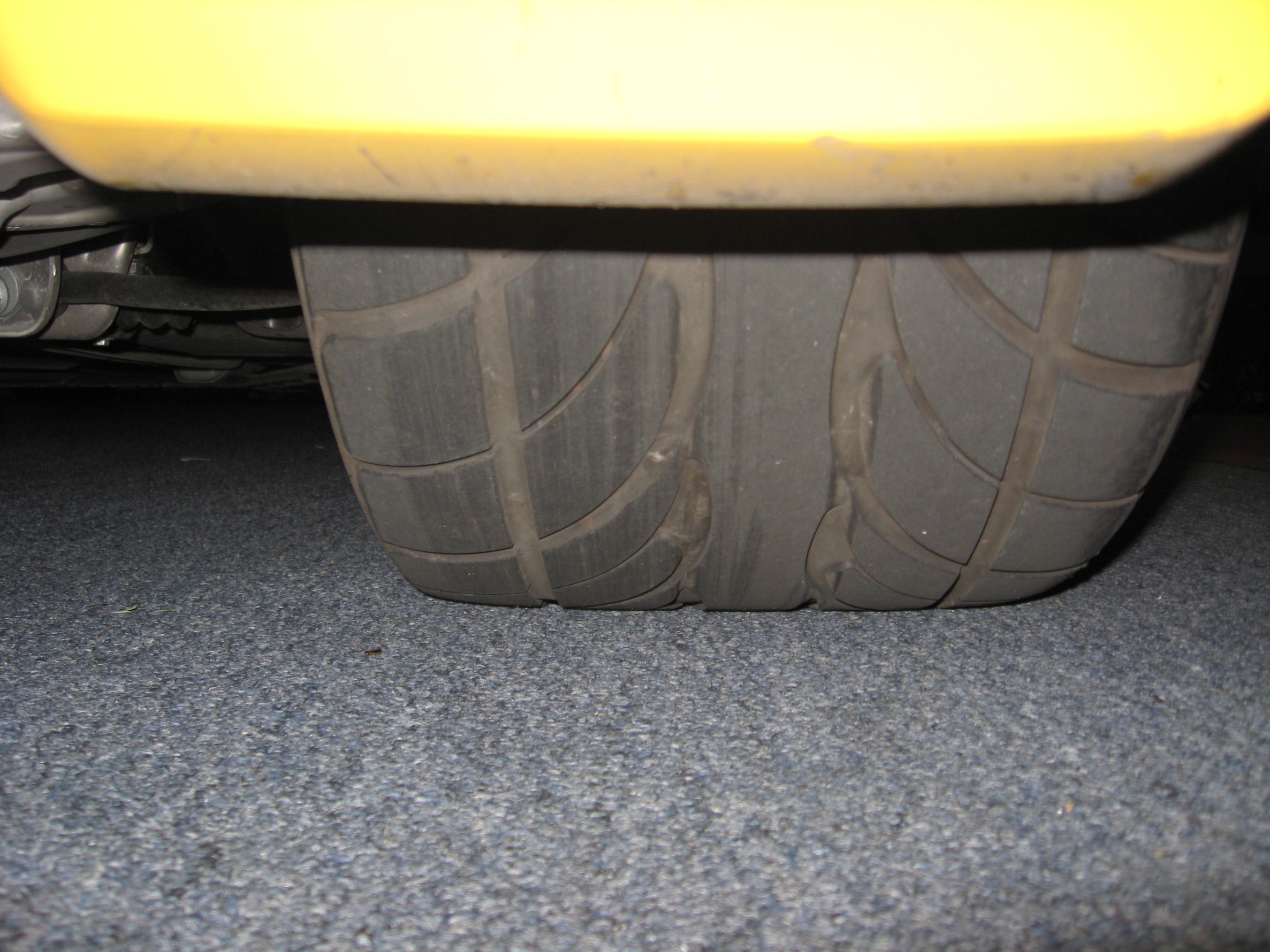

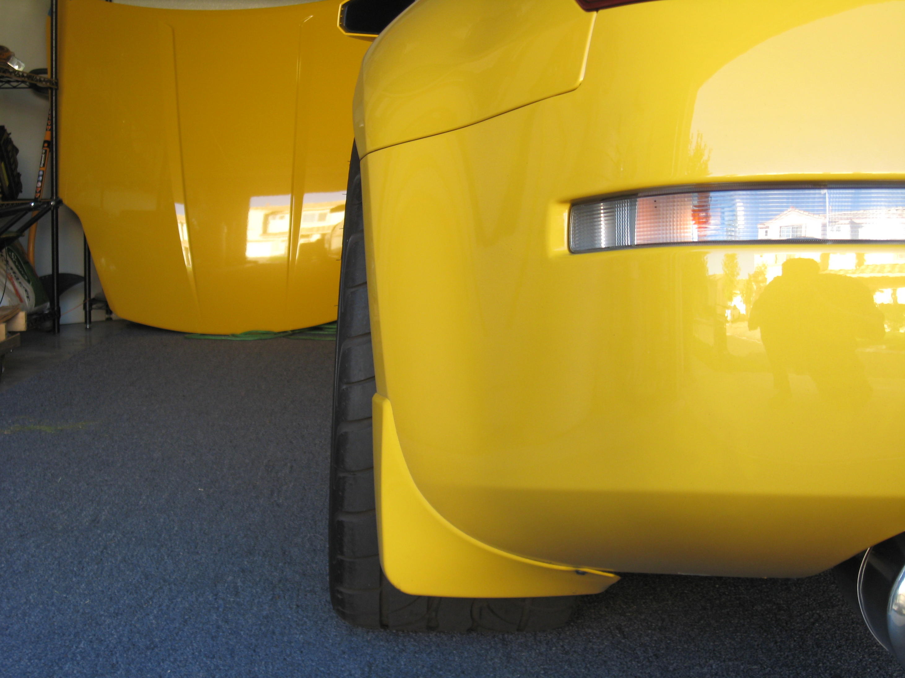

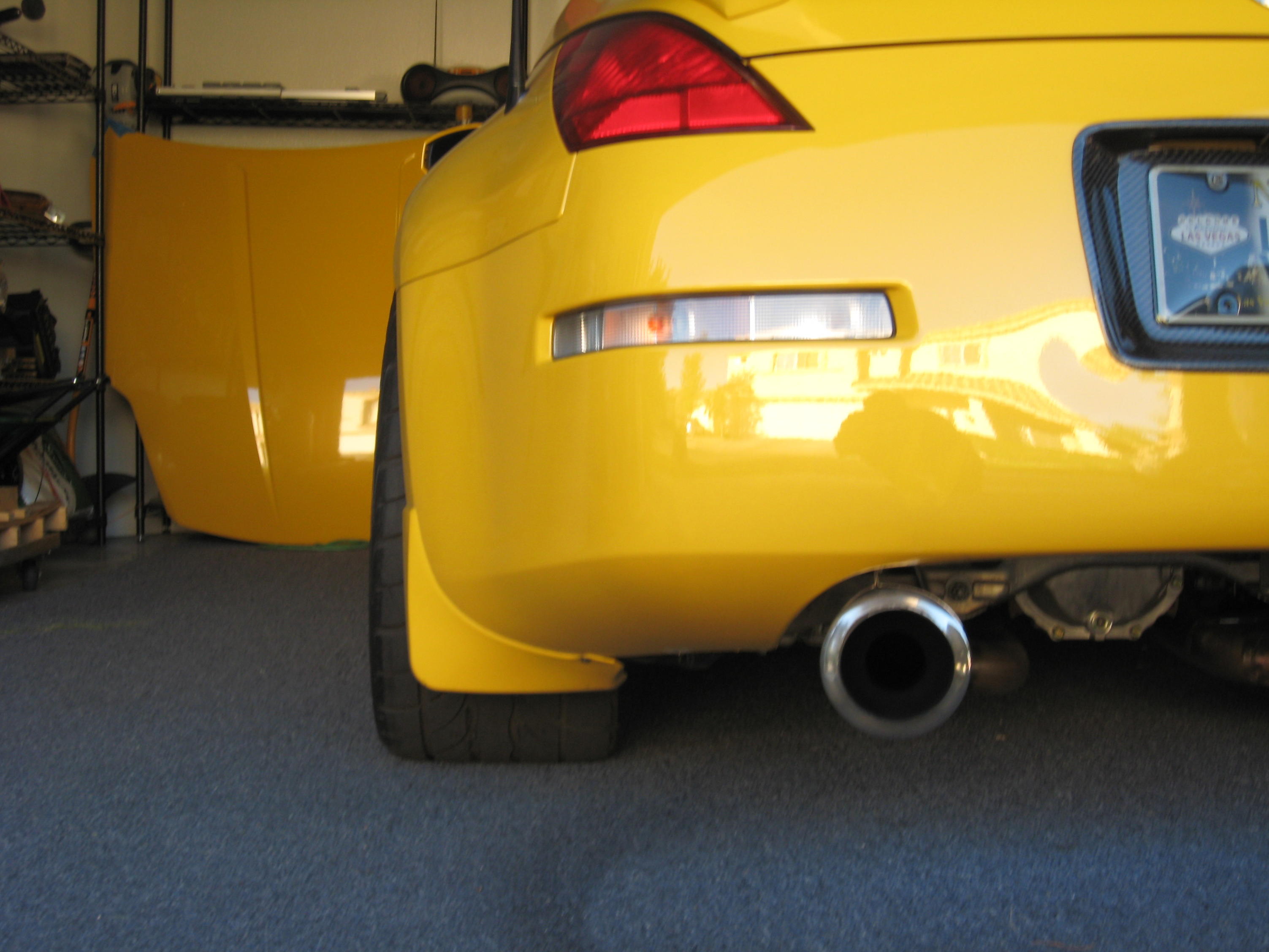

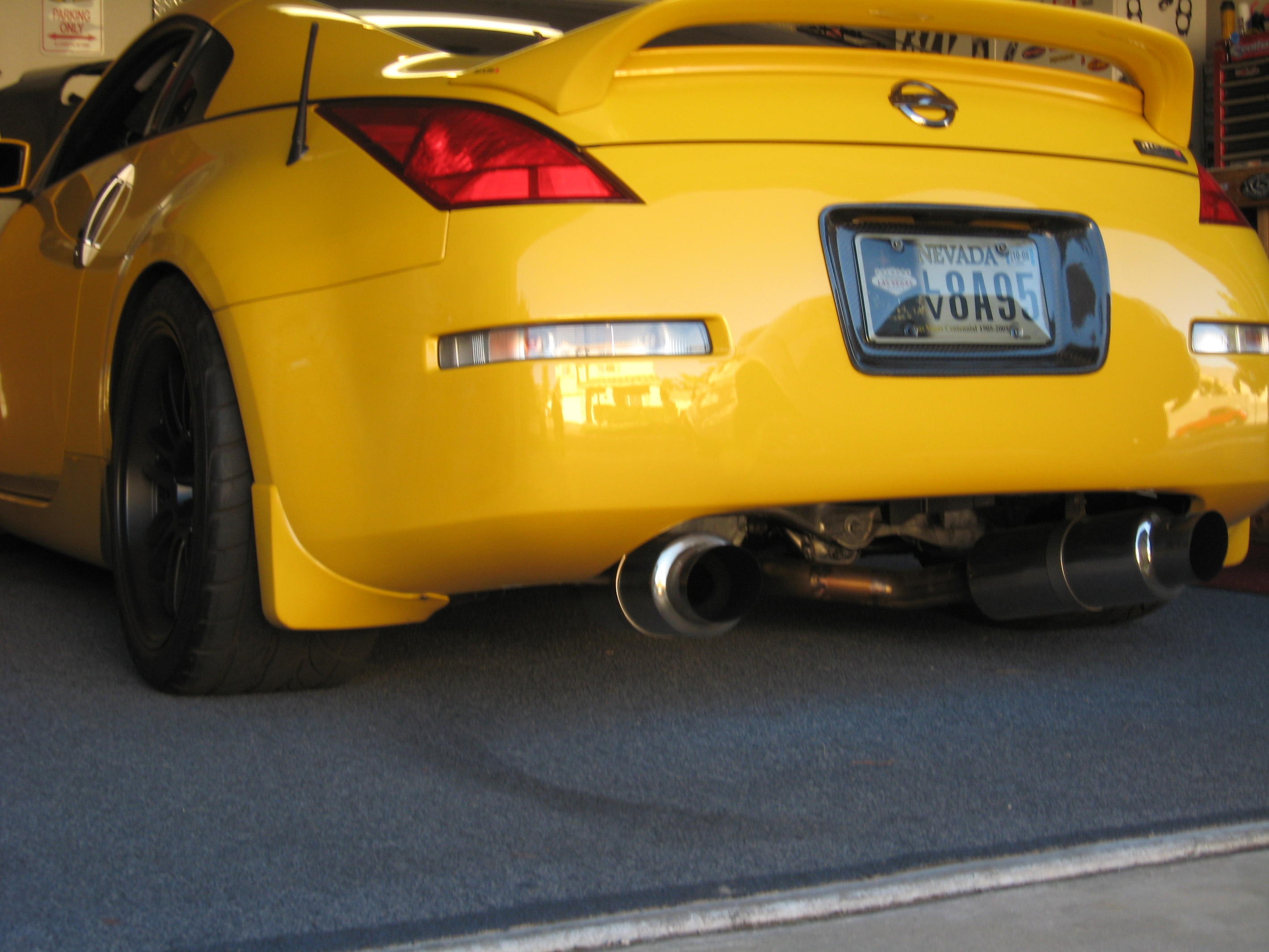

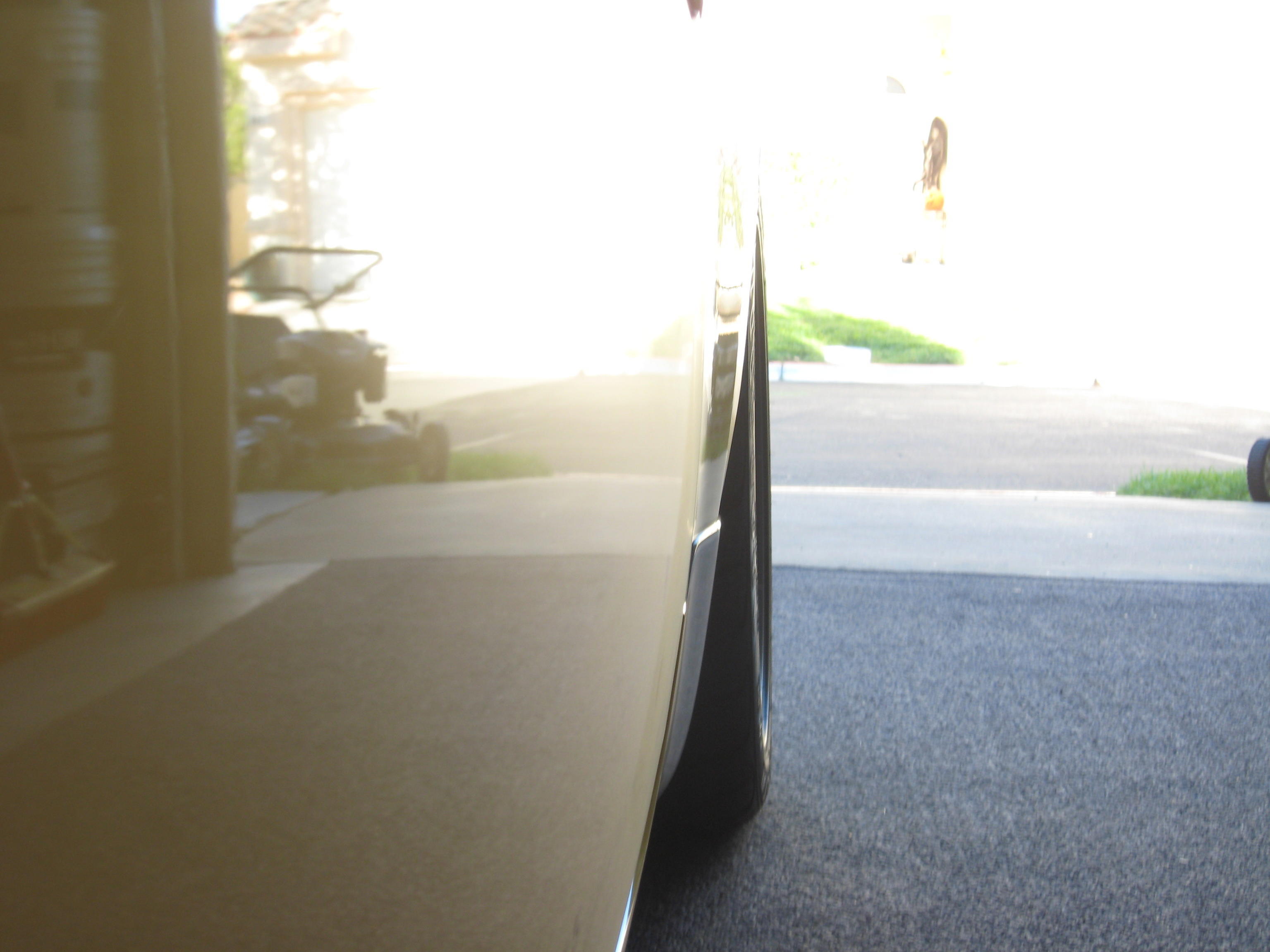

i took some pic's today, just looking at my camber and seeing my contact patch/wear on my rear tires what kind of camber do you think i am running in the back "ball park"? reason being is i have been doing alot of research on do it yourself aligments. the articles are very informative and it can be accomplished with readily available tooling. i am willing to take a stab at it even if it takes me a whole weekend and some! after i feel i have gotten the spec's that i am looking for i may have it checked at a reputible aligment shop to DOUBLE CHECK my settings. one of the articles is a step by step procedure that is performed on a 240sx which is great due to it has a similar suspension system to the z " rear irs ".
