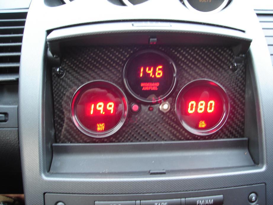

you could try something like this for your guages. They are velcro'ed to the cluster. Sorry for the shitty pic, I was doing 80 when I took this one. I can take better pics if your interested. The gauges are centered and everything is visible.

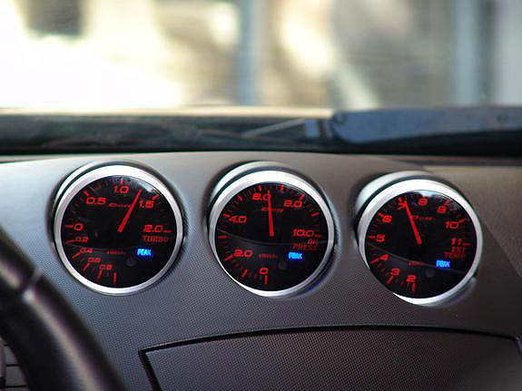

Most people seem to shy away from that setup for the gauges, I think it creates a bad sight line or something like that. Since you have crazy fab skills, have you ever worked with fiberglass? You should PM XKR and ask him to send you a pic of where Forged custom mounted his gauges - they look great! It may not even be that difficult to do.
Just offering alternate ideas. The build looks great so far BTW.

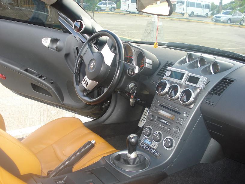

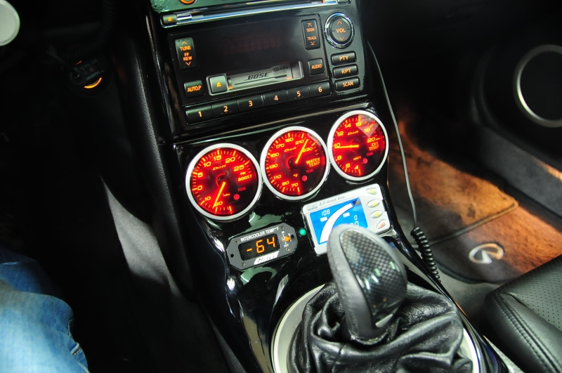

Here's a few mounting options for gauges:
