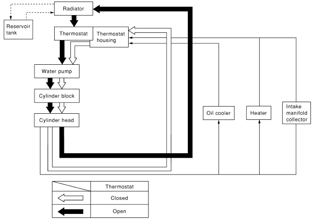

Originally Posted by redmist
You need to think a little more.
If you have no flow, you have no temperature change at the thermostat. Once the engine coolant is up to temperature.... well, nothing happens as there is no temperature change at the thermostat! This is the entire reason cars have a bypass, in order to flow heated water over the stat, heat the thermostat so that it may open. The bypass most certainly has absolutely nothing to do with getting an engine up to temperature faster (that’s what a thermostat is for). It's job is to heat the thermostat so that it may open, and possibly stop un-uniform water pressure buildup. Without it, the thermostat will open considerably later, and after the water at the heads is considerably over temperature (as the thermostat will be heated eventually by heat soak).
I suspect that also with the thermostat closed and no bypass you'll be cavitating the water pump, and cause hot spots in the head. However this is purely conjecture.
its been a while since i did all my coolant line work, but if I remember correctly, the oil cooler/warmer circuit flows into the t-stat housing along with the lower radiator hose. the oil cooler/warmer hose starts directly adjacent to the bypass hose on the passenger side coolant pipe, is routed down below the engine, and ends at the port on the t-stat housing. this is the path that warmed coolant follows to get to the spring on the t-stat. the bypass plays a role, but it is not the primary path that coolant takes to get to the t-stat.
given where the bypass hose actually plugs into the block (passenger side, slightly forward of the center of the block) i believe its primary function is to help both sides of the engine get up to temp quickly and at roughly the same pace. i've attached a diagram from the FSM to show the multiple paths coolant takes to get back into the block.
