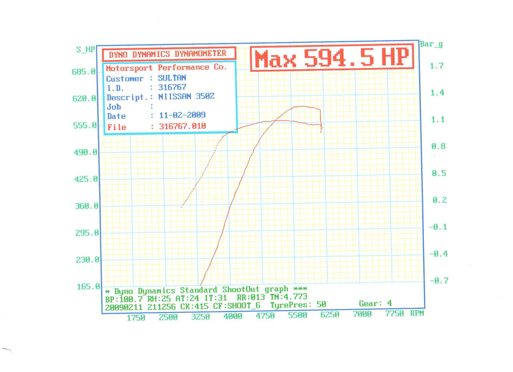

I think this kit is fine to reach 600whp I have one we didn't finish tuning it
and at 14.5 psi we reached 505 whp and 498 t we can easy reach 530 at the
same psi see the dyno sheet

u sure thats the same kit? looks a lil laggy for such lil turbos....and yea where did jayz thread go??!!
What is the rest of your setup, if you dont mind me asking? Also, do you have the newer style with the journal bearings or the older BB style Garretts?
What psi for the 594whp? pump gas or 110 octane (US measure rating)? Using methanol at all?

no no 594 hp not on wheel 505whp 594hp on flywheel we use pump gas 97
no meth or anything else
ahhhh, we all talk in terms of wheel hp on here....my goal is 600+whp
From what bryan@Z1 tells me the 505whp on a DD is close to the max out on the new turbos. I may be able to get close to 550whp, but that will be pushing the turbos to their limits.

I haven't tried to go more than 16 psi but I think they can handle 600whp believe me
don't wast your money 600whp is more than you need for a street car ^_^
