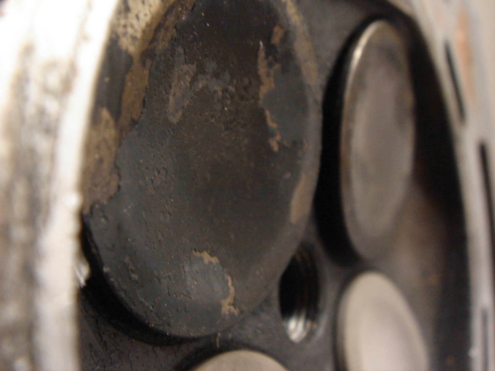

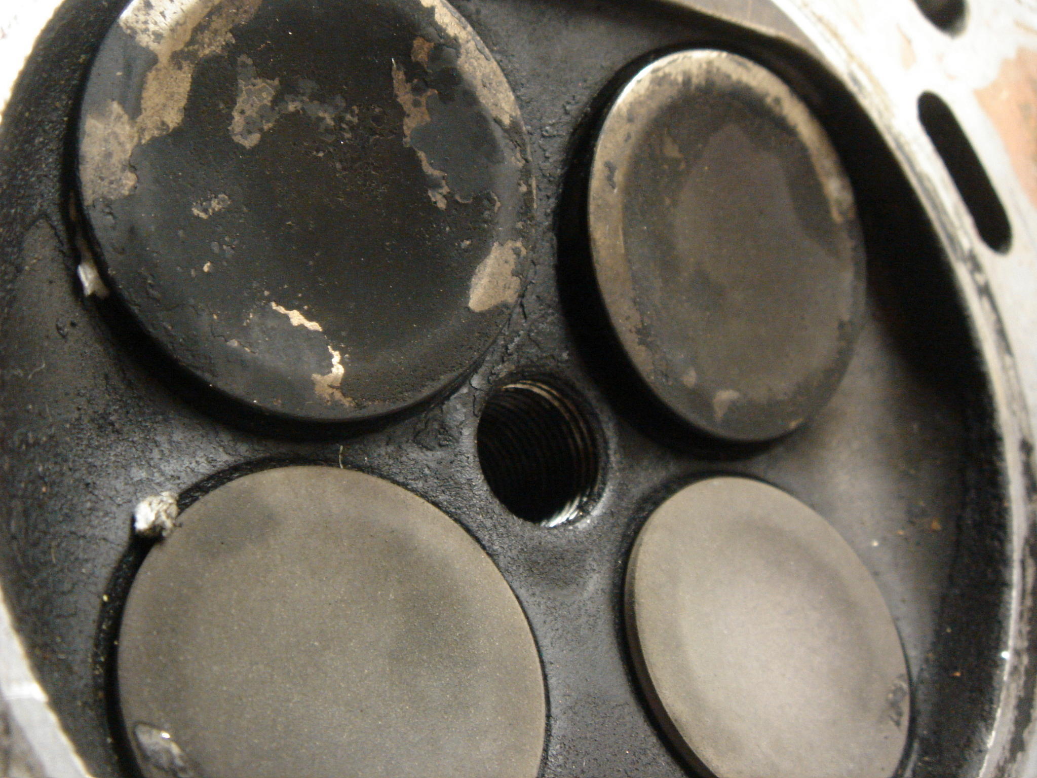

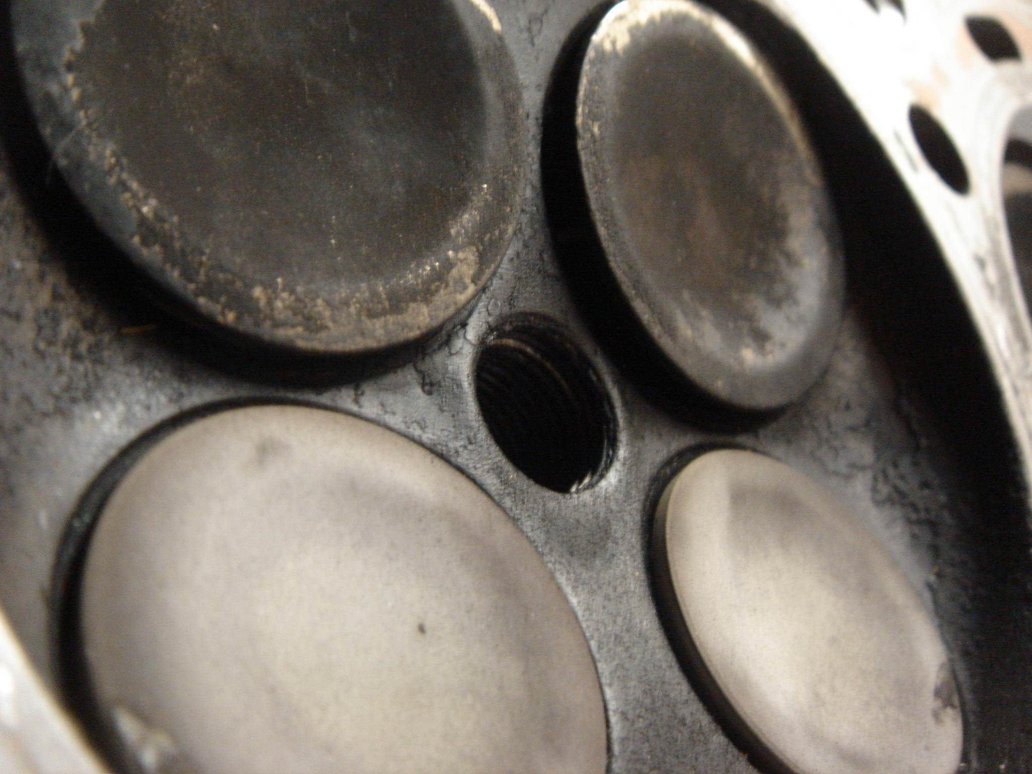

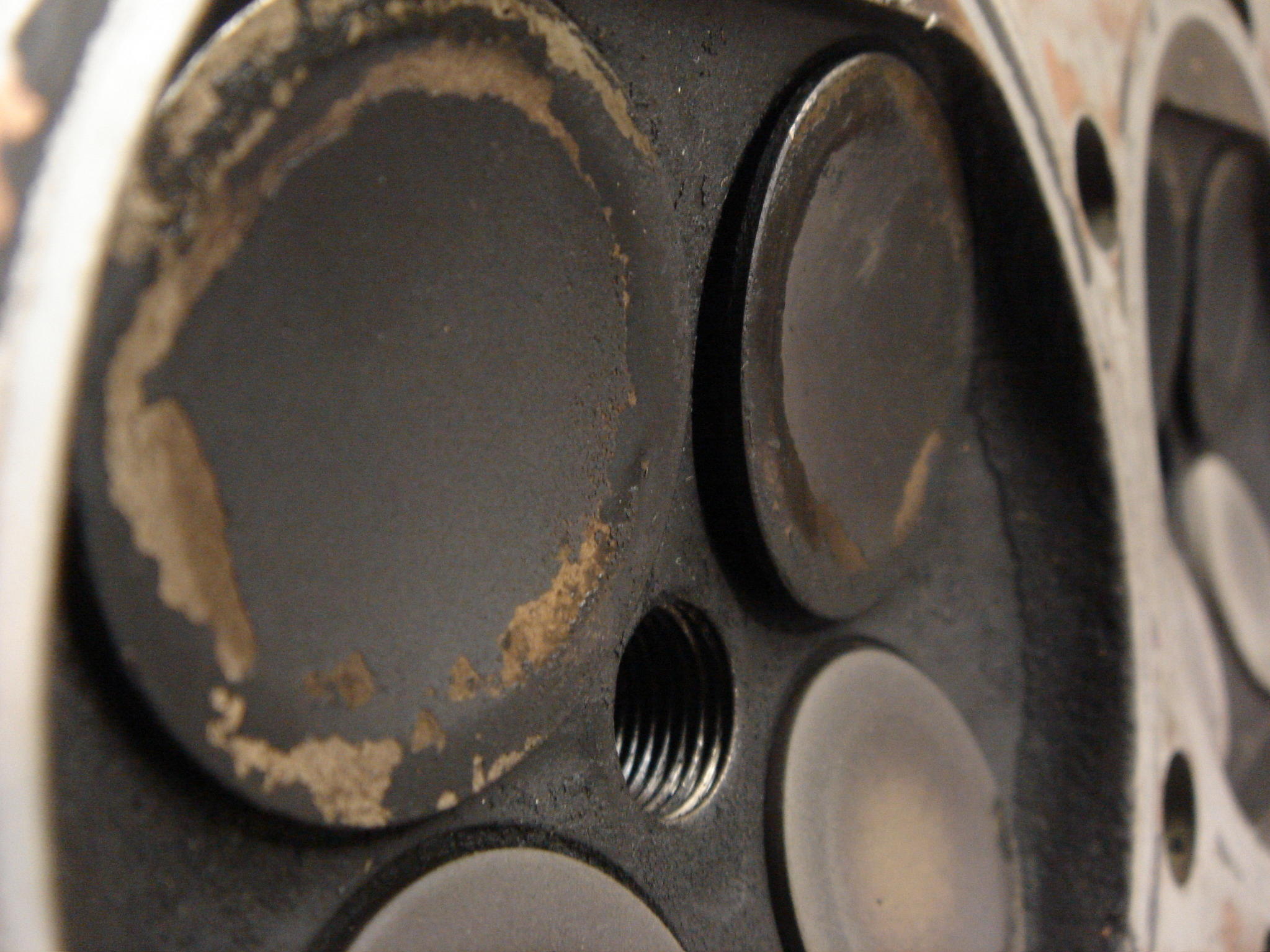

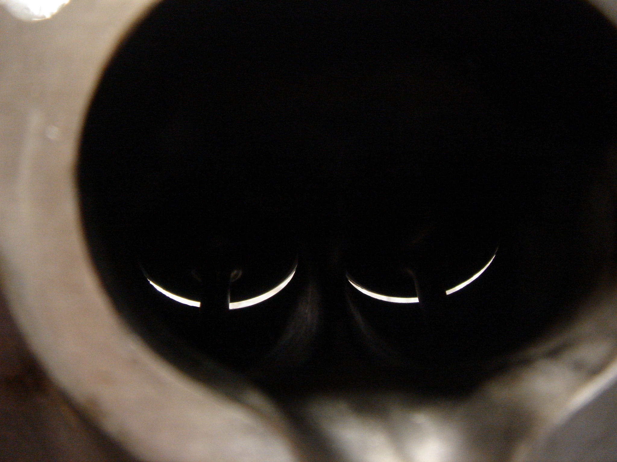

hey everyone. I bought built heads off of a member on here. i inspected them when i got them and have a few questions....
first off, they're sgp built heads with ferrera 1mm oversize valves, jwt s2 cams, ferrera valve train.
now, when i got them and inspected them, the valves arent shut all the way like normal valves usually are. so i figured, maybe the cams are stuck holding the valves open.... no. i checked out all the cams to see how they were set, all were fine but one. one cam has lots of play in it. check out the attached video to see what im saying:
<object width="425" height="344"><param name="movie" value="http://www.youtube.com/v/VcoFf8qAIlk&hl=en&fs=1"></param><param name="allowFullScreen" value="true"></param><param name="allowscriptaccess" value="always"></param><embed src="http://www.youtube.com/v/VcoFf8qAIlk&hl=en&fs=1" type="application/x-shockwave-flash" allowscriptaccess="always" allowfullscreen="true" width="425" height="344"></embed></object>
so it looks as tho the valves are bent. but im no expert here so i took pics and attached them too. they dont seal all the way to the head which trips me out. check out the attached pics and let me know what you think.
now, before you go and say, "dude you got ripped off from some member here on the forums. thats F'ed up and etc.." i have already spoken to the member on this board and hes being very cooperative here with figuring out what agreement we can come to.
so what do you guys think about this? bent valves? something else?

Those heads are bogus. The valves are bent. These should not have been sold as good heads! If you need some help let me know.
Tim

in your pics it looks like the intake valve are bent. But its hard to tell. In your video that is the intake cam that has play in it. That aint right at all. My guess is that the intake valves have some problems.
