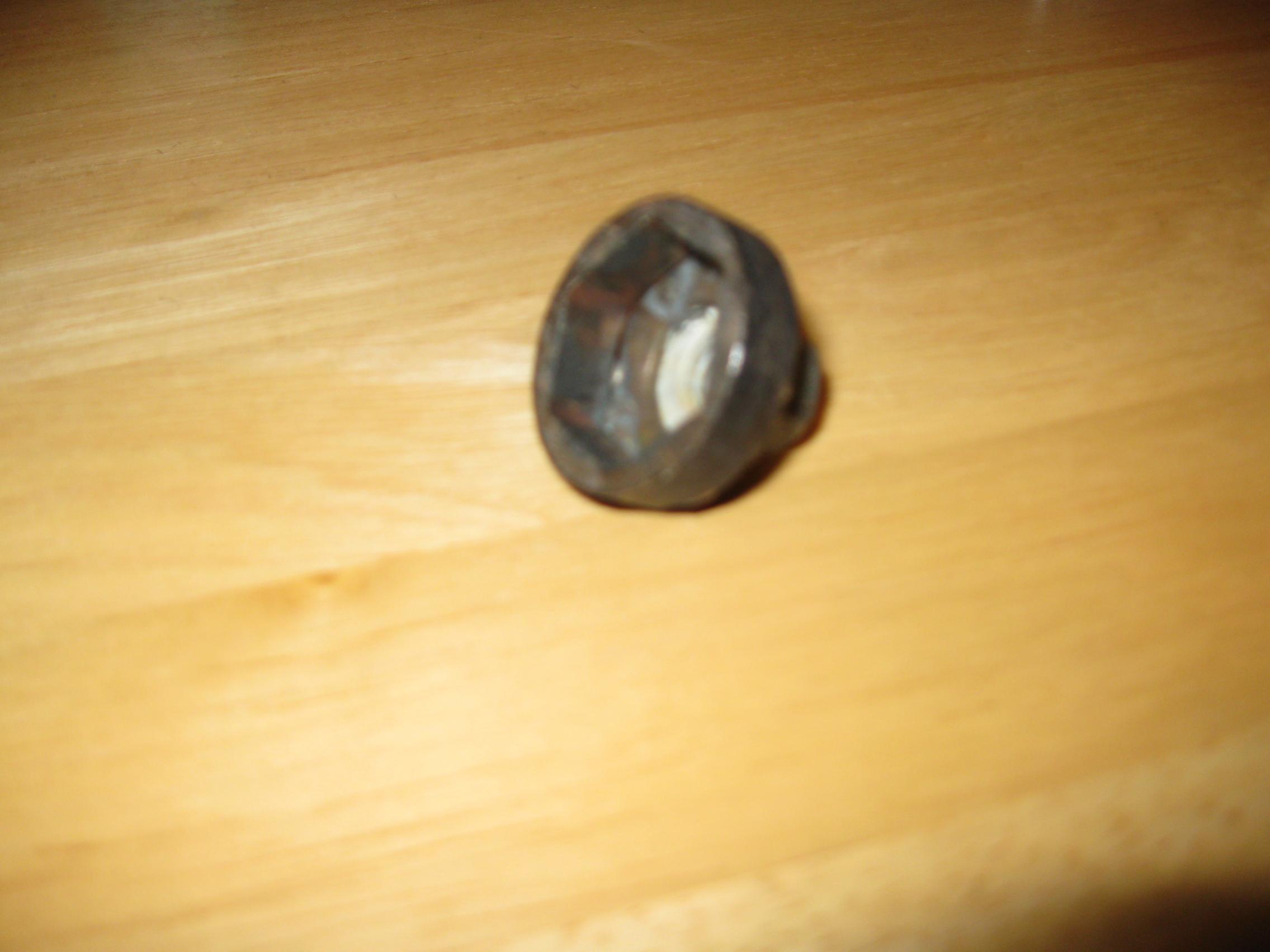

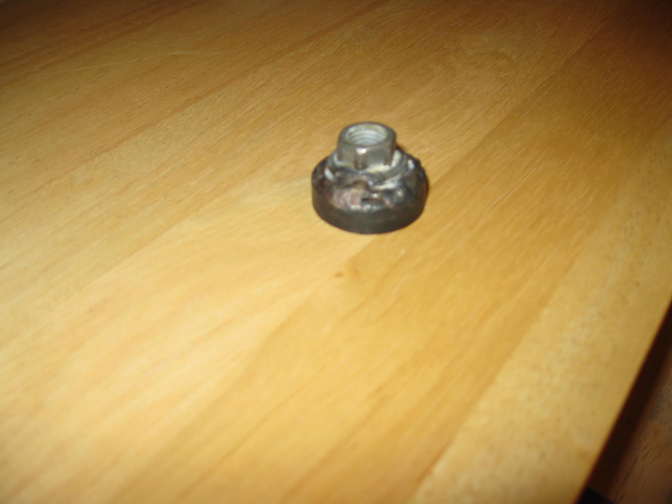

There are so many little thing, since it has been a while since I did the install I might forget a few things.
*install good clutch
1.removing studs from head- a 12 point socket will fit the end
2. I think I had to take the heat shields off to get to stuff later in the build, just put them on before the charged piping at the end.
3. Mounting the turbos were the worst thing, I cut the wrench and had to grind it so I could rotate the wrench for enough.
4. once the passenger side turbo is installed put the silicon coupler on the compressor outlet and you can adj. the housing so the coupler is not rubbing against anything and tight the bolts before the exhaust is in place. You can see the angle on page 109 of the instructions pic. r
5. The water inlet banjo bolts were a pain too, I had to make a tool to get these tight. I cut a piece of socket(7/8) and welded a smaller nut to the piece. I can post a pic. no room to rotate a 7/8 wench in there. These things leaked for weeks after the install was done.
6. I had to buy a carbide bit for the dremel tool to grind the exhaust gasket and pipe flange holes to fit on the turbo. The next thing was I used nuts and washers to mount the down pipe to the turbo. The flanged nuts they supply hit the welds and can cause the studs to bend causing problems latter in life.Also the O2 sensor should be put in know In the top holes. skip the middle holes, there spares.
7. For external waste gates tubes- I did use allen heads here too. The pass. side waste gate tube and down pipe both had to be beaten with a hammer(2 pound sledge, stainless is hard). hopefully there tooling has been changed to correct the problem.
8. the cross brace under the car that connects to the exhaust and trans. did not fit and never made into the car.
9. I had to buy new screws to mount the intercooler brackets.
10. The oil distribution block goes on the front of the engine between the engine and oil pressure sending unit. It seemed like there were specific hole locations for everything here.
11. On the the piping not all of the support brackets lined up with the intended locations. I never corrected this.
