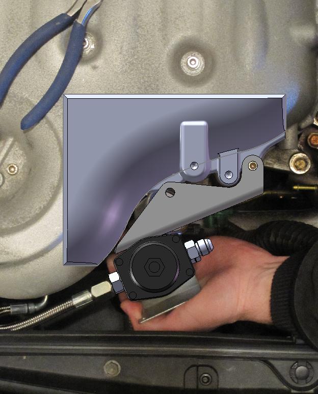

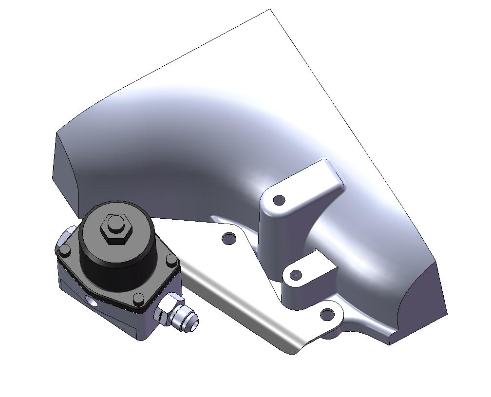

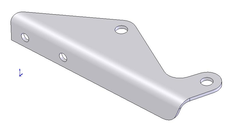

I have an update on this subject!
Since it is winter here in Michigan and the G is going nowhere fast, I decided to spend some time modeling the plenum and Aeromotive FPR in order to design a bracket which would mount the FPR to the plenum rather than the firewall. I fabricated the bracket and bolted it together last night. I started the car and let it warm up so the idle would come down and guess what...no more ticking sound! The sound of "flowing fuel" was also greatly reduced. The only thing I can hear now is the exhaust, a slight fuel pump whine, and a very quiet sound of the fuel being returned to the tank.
I had to turn the regulator 180 degrees so that the mounting holes would be on the other side, which is why the fitting for the fuel line is shown on the wrong side in the pictures. All I had to do was switch the fitting and the plug so that the fuel would enter on the other side of the regulator.
I don't have any pictures of the actual piece yet but here is a couple CAD screenshots of the bracket. I made it out of .093" stainless and polished it to a mirror finish...it looks sweet!
Attached Thumbnails Why does my turbo car sound like a diesel?-fpr-bracket-assy.jpg   Why does my turbo car sound like a diesel?-fpr-bracket.jpg   Why does my turbo car sound like a diesel?-fpr-with-background.jpg

Nice fabrication work. Out of curiosity, how much fuel spills out when disconnecting that line (with the car off of course).

Nice work, I also mounted my to the plenum. I had to because all my lines are aluminum, so no flexing allowed. My setup is a bit simpler though, just some aluminum twisted 180deg:

Not too much really, maybe an ounce or so.
