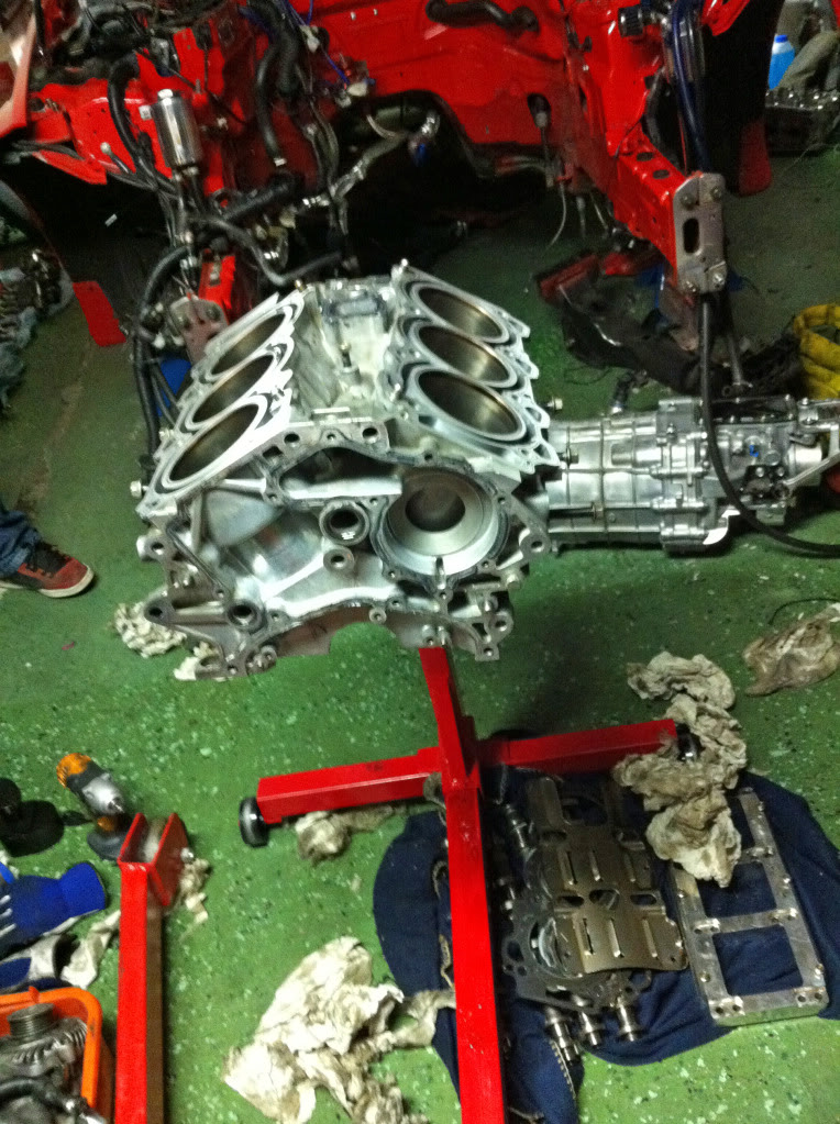

I'm going to try max my (genuine) 20G's out this spring. Pulled engine last week and striped the block. The rotating parts is now at my machine shop for balancing. Heads will probably get some more porting at exhaust side.
I've swapped my Eagle rods for Carillo Pro H-beams, which is the main reason for doing this.
I've now got a 3.5 Bar map sensor making Haltech boost limit history. Going to stay w/ stock bore and no Darton's
I had 6200 miles 2010 w/ that build and it was lots of track and drifting at the rev limit. Engine parts was like new, bearings shining w/o wear. Almost sad feeling finding it in such good shape I'm on E85 and that is supposed to be hard on internals like bearings but the ACL's have zero traces of it, maybe due to Motul 300v oil.
I'll for sure update w/ my numbers after tuning
Last week in my garage
