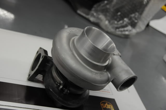

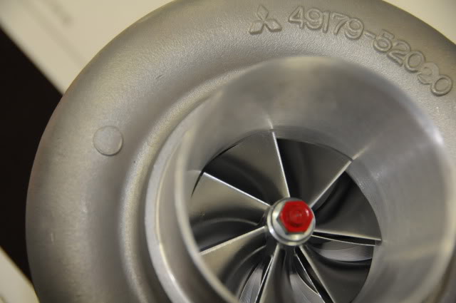

theres also the HTA upgrade from Forced Performance for Greddy Kits. theres a 82mm, 76mm, and a 72mm upgrade option... Still waiting on results/word from Sharif on those. I called up there and spoke to Forced Performance and they say its better than the 20g option ..
I think one of you more knowledgeable guys need to call up there and translate what he told me into plain English for us common folk please ..lol
Forced Performance: (972) 984-1800
www.forcedperformance.com
taken from: https://my350z.com/forum/forced-indu...upgrade-5.html
