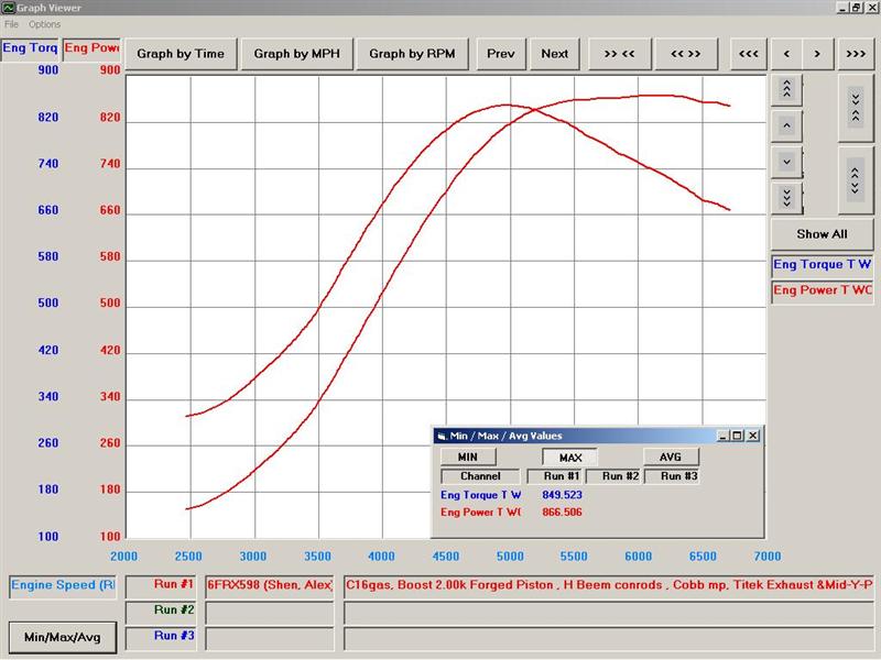

Originally Posted by thom000001
Interesting to see where the 20G's run out of breath...
Tom
Originally Posted by TwoFiveBar
SPE's GT-R put down 866awhp/849awtq with the TD06SH20Gs.
2 Bar, C16.
9.6@150mph w/ Drag Radials
However, I am not sure if they are using the standard hot side (IIRC 8cm^2) or one of the larger options GReddy offers.
I'd imagine this is approaching if not past the limit of the compressor. I've seen GT28 series Garretts hold boost and never lose power on the same platform all the way to 7500rpm at 27psi (about 750/750). So from the looks of it, that's about it for those 20gs. But again, it hard to tell without being there during the testing, looking at the boost curve, data etc. Remember, this graph is from an awd vehicle with (iirc) stock heads/cams. No doubt the car is fast as hell though. LOL, even with 18s and drag radials, 9.6 in pretty much street trim is ridiculous.
