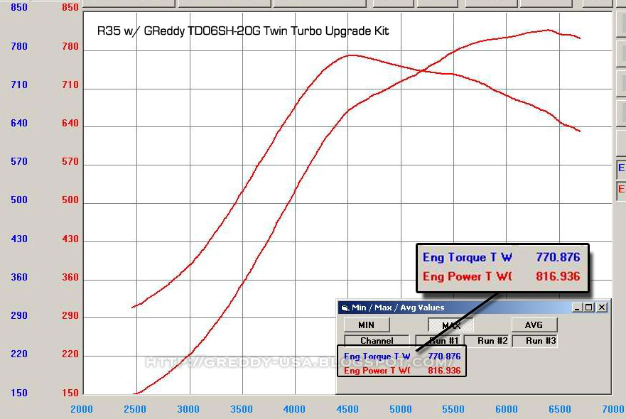

GReddy R35 TD06SH-20 Twin Turbo Upgrade Kit. Well we are happy to report an update. Over the weekend, they began to boost up a little more from their 706whp @ 1.45kg/cm2 to a crazy 816whp @ 1.7kg/cm2!
Not only does it make great peak power, but if you notice on the graph, the mid range is still quite good with 360whp at 3500 RPM & 520whp @ 4000 RPM...
And the guys at SP Eng, tell us they are not done yet. We can't wait to see how much they end up with!

Interesting to see where the 20G's run out of breath...
