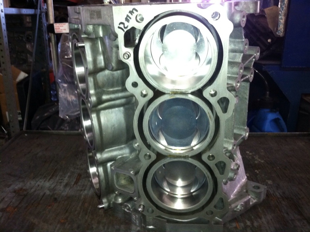

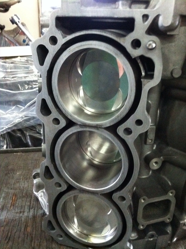

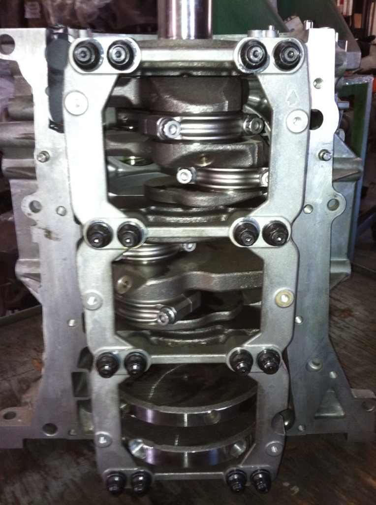

Old Dec 23, 2011 | 09:17 AM
  #662
dikspiel's Avatar
dikspiel
Chestons Toilet
iTrader: (70)
Posts: 8,859
Likes: 92
From: Cheston's

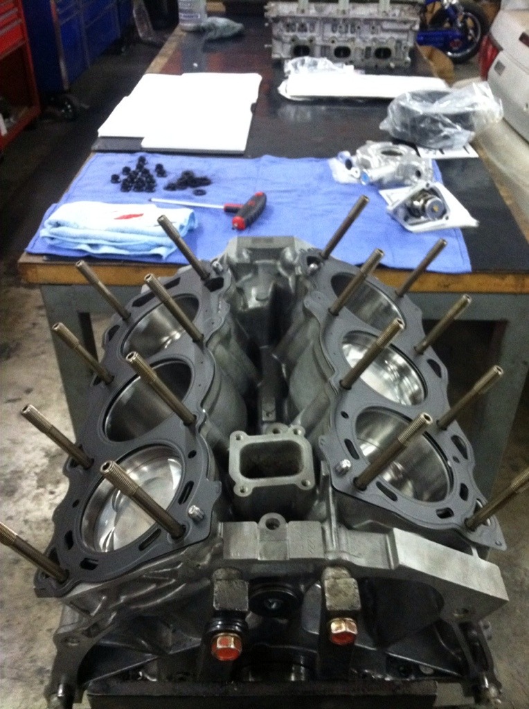

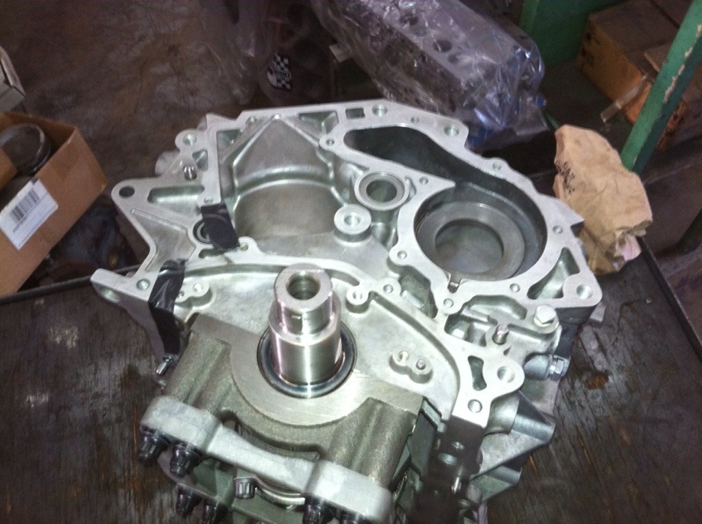

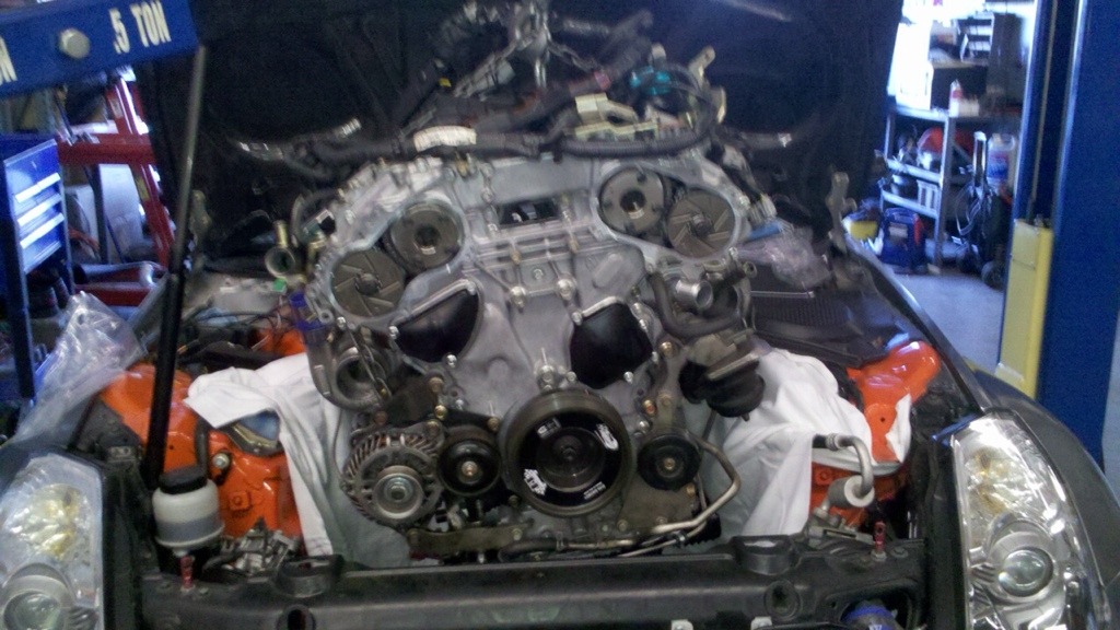

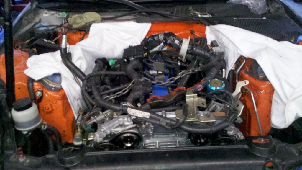

Old Dec 23, 2011 | 09:39 AM
  #663
ace32x's Avatar
ace32x
Joined: Feb 2009
Posts: 3,016
From: puyallup WA
doesnt look running to me...
looks good though!

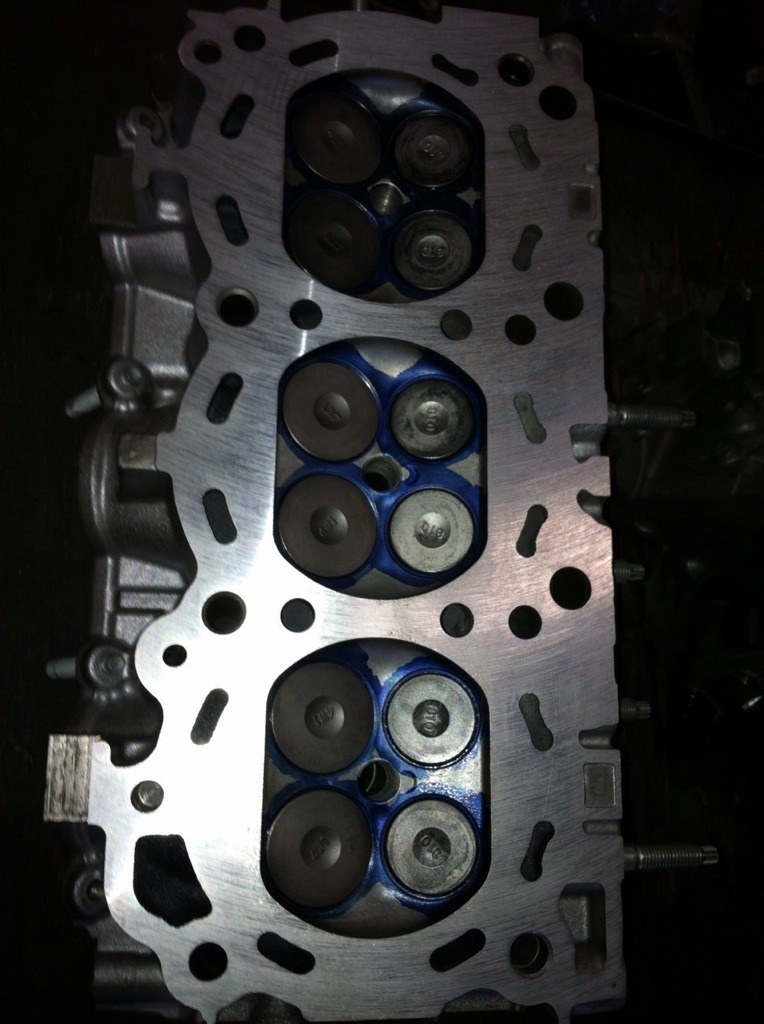

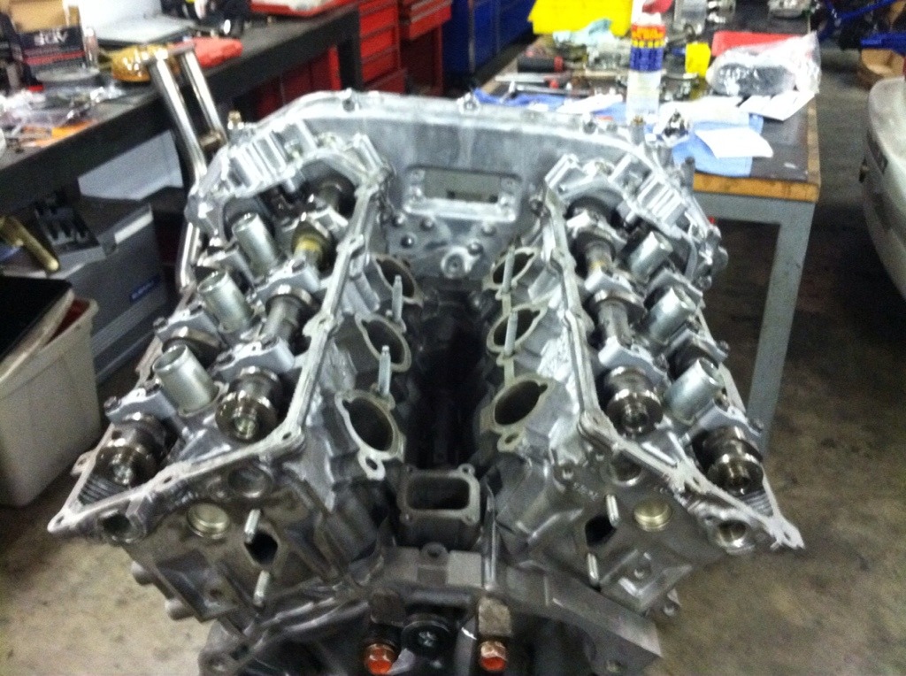

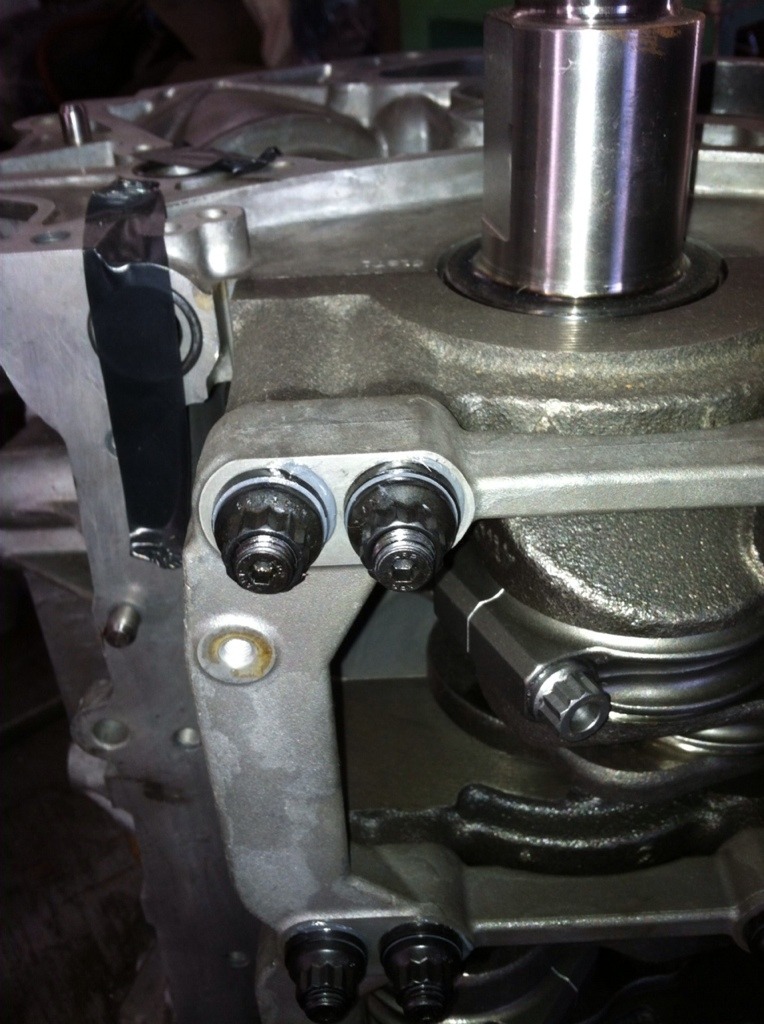

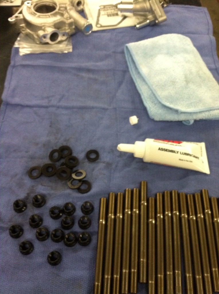

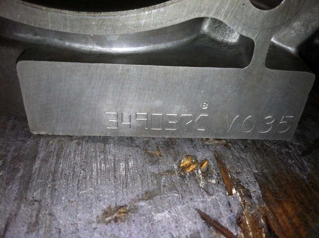

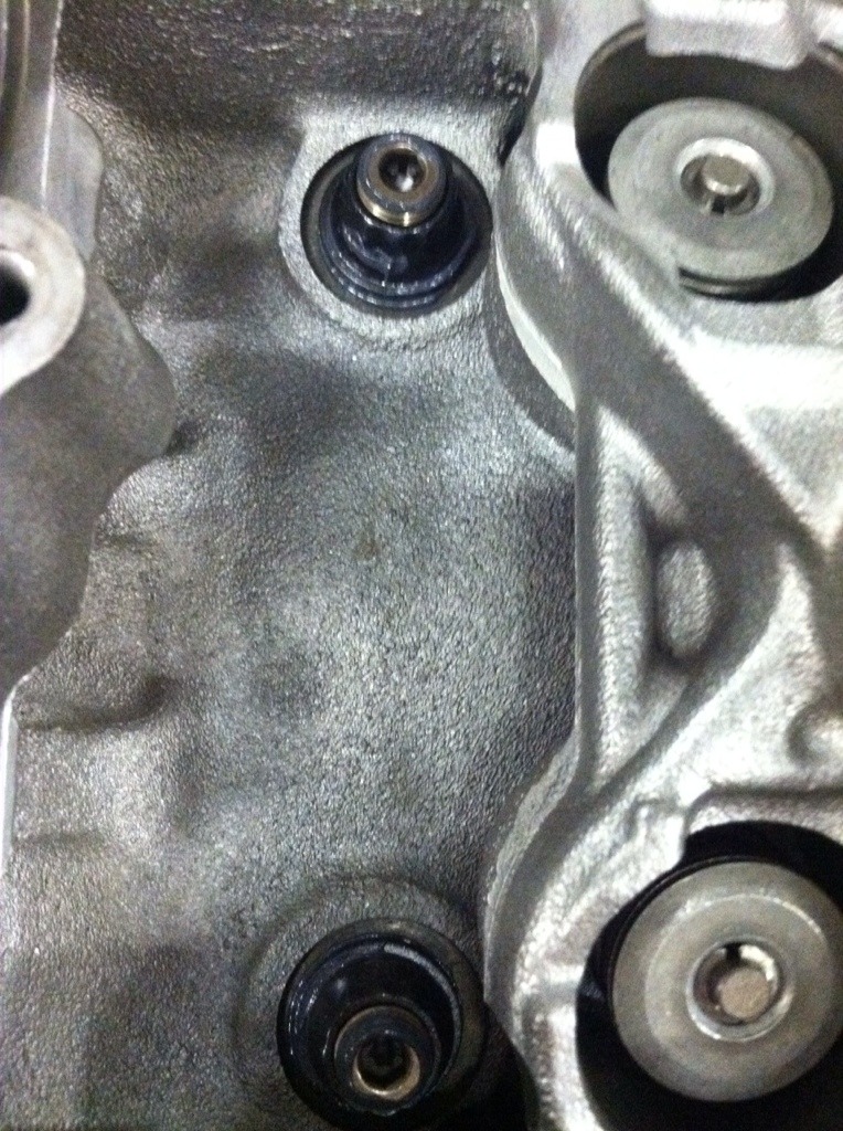

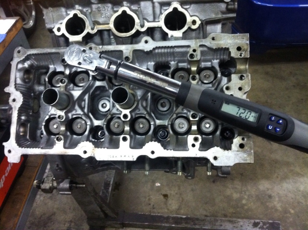

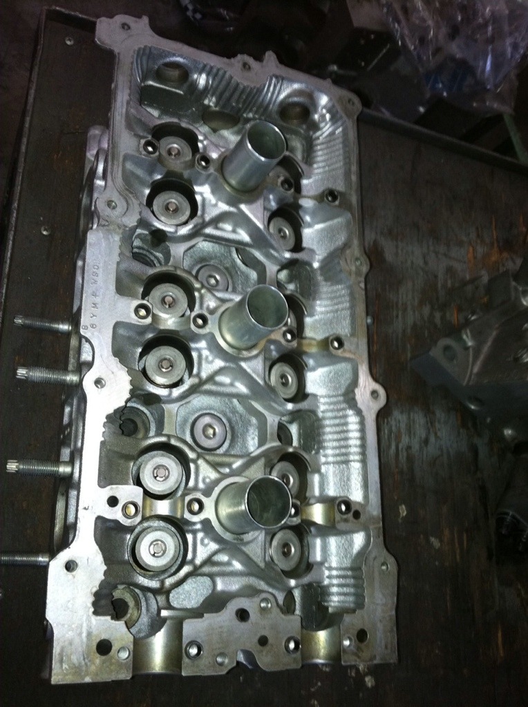

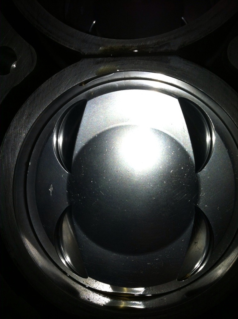

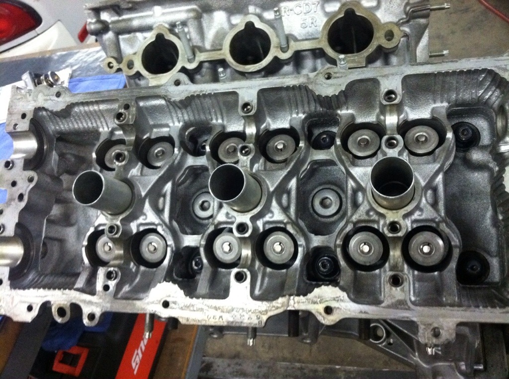

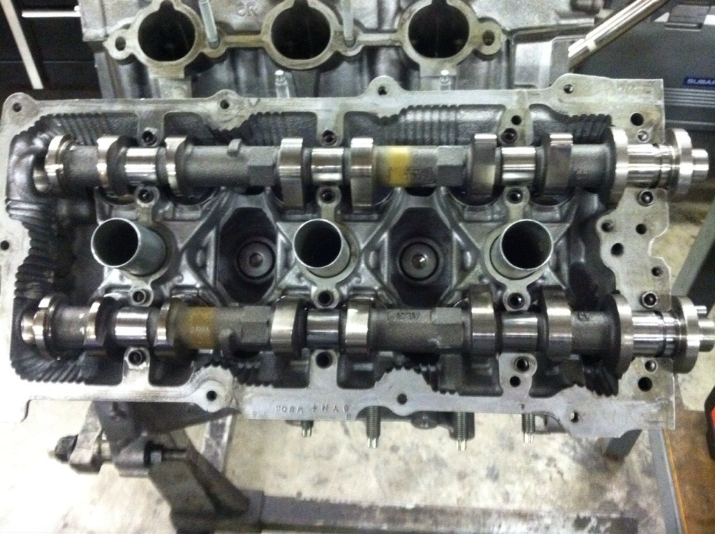

There was detonation on the valves so heads were disassembled, valves were cut, seats were cut, new valve guide seals were installed and reassembled.

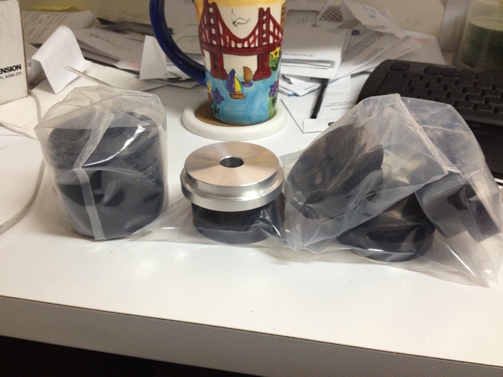

Also picked up the SPL Diff Bushings for better traction:
