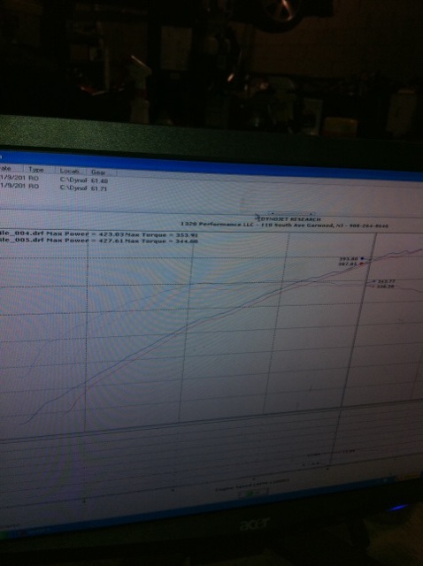

427.61hp/344.60 lbs of torque with 440cc injectors and GTM stage 1 full return system @ 6.4psi
