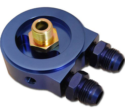

What sandwich plate are you guys using? The one I have only has 4 ports small enough to run my oil feed line to my Vortech. I want to run an oil cooler now, so I need the proper plate for that. Is the feed line for the blower 1/8 or 1/4? I can't remember. Thanks

So would it be safe to run an oil cooler through a plate like this, and feed the Vortech through one of the side ports?
Would this also cool the oil going to the blower? Also being that I live in South Fla, do I need a thermostatic plate?

Looks pretty well made, and provided that is the inlet from the cooler it should be fine... but I don't know enough about the FI plumbing to give a valid opinion (merely a guess).
Attachment 287900
Ya, that plate will be safe.
You can feed the vortech through one of the side ports as long as it's not a thermostatic plate. Thermo plates will have that shut down when the oil isn't warmed up and that's bad.
Now, depending where the small port is will tell if the vortech gets normal oil or cooled oil. All the oil in your car should be cooler when running a cooler though so no worries there. If that port is on the return side then the vortech WILL get oil right after it passes through the cooler.
About needing a thermo kit. I'm not sure about south florida, but i know over the winter this last year my brother had temps down in teh 40's in daytona. I know up here in indiana my oil temps stay about 120-130 on the highway WITHOUT an oil cooler so it would be even lower if i had an open oil cooler (when the outside temp's are down in the 40's).
So if you get cold nights in the winter and still drive your car i would recommend a thermostat on there. If you are ok with 100 degree oil temps in the winters at night then no need for them.
basically anywhere here in the US that has temps below 60 degrees AT ANY POINT and you will be driving your car you should probably have a thermostat. So pretty much every street driven vehicle. I guess you could also just put some cardboard over your cooler in teh winter if you wanted. That should work.
