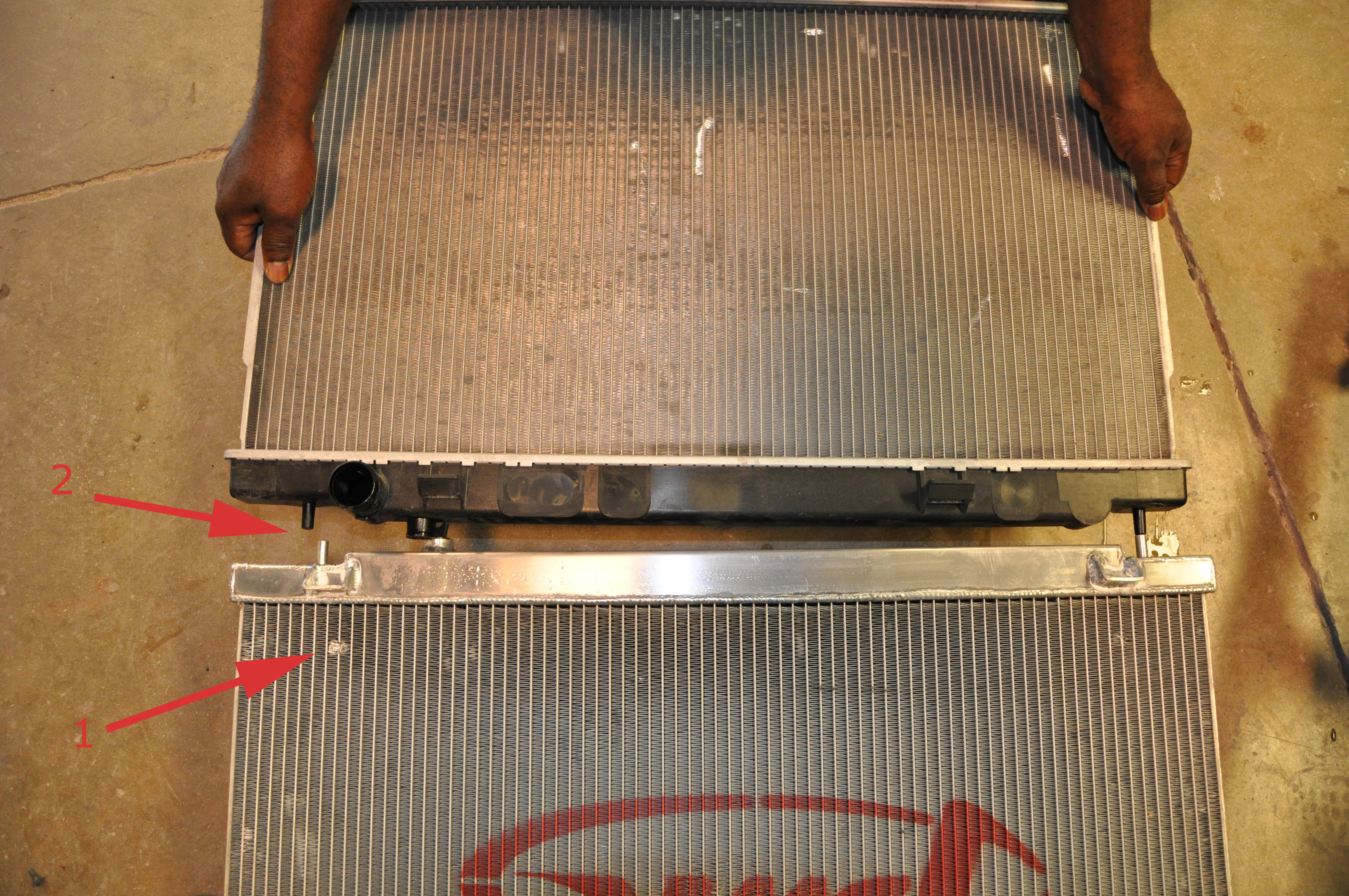

Anyone installed these without any issues at all?
So far I've had to hone all metal mounting tabs for the radiator fan tabs to fit, only to find out the lower mounting posts are about 1/2" closer together than the OEM holes. Once installed the lower AC condenser mounting brackets hit the fiberglass radiator support ended up rubbing through the radiator and coolant all over the floor...
I'm a bit peeved after being told this is a direct-fit drop-in replacement on the G35. Even the mods required for the 350z have nothing to do with the issues I experienced.. still waiting to hear back from Sam but I just would like to know what other experiences have been.

Just to put closure to this thread, Sam emailed me these pics and we were able to make it fit by mounting the OEM A/C condenser as shown (in addition to widening the lower mounting holes to line up with the PWR's mis-aligned grommet/pegs):
