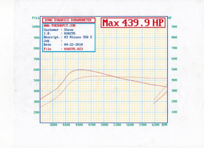

I had a similar problem, fully built block all supporting mods and powerlab kit is having trouble, not at fault to the kit, not directly. Flow tests done on the car, had shown that the HOT SIDE IS TOO RESTRICTIVE. The .82 A/R allows for a quicker spool but acts similar to having a restrictive exhaust. I was told to get either a 1.03 or 1.06 A/R to remedy the problem, but have been unable to install it due to my current situation. The piping can make the power, but the turbo in its current configuration cannot. I put my dyno up, to show that at 21 PSI it makes a merger 440rwhp, but 615rwtrq. Most people do say that well the kit makes 420 at 8psi but thats a high compression block, mine is a low compression. This is on pump.

I apologize as I have been in the shop trying to finish up some cars before we head to ZdayZ this weekend. A few quick responses to some of the points I have seen made regarding the OP. First, Injected Performance did not request that the OP make this thread, and he can verify this. James (the OP) is very aware that his car would not make 650rwhp on pump gas. He stated he was hoping for 500rwhp with the built motor, fuel, cams, etc. James is a very educated car enthusiast. We do not feel that 500rwhp was out of the range of what to expect with what was done to his car and paired with a GT35 turbo.
Furthermore, I will respond to a few questions that have been asked publicly and privately to myself and James.
  1. Compression test on the motor shows that it is well within our specs. There is a .08% variance across all cylinders.
  2. Duty Cycle on injectors does not show any issues with fuel supply.
  3. All intercooler pipes have been pressure tested and do not leak.
  4. No issue with melted or clogged catalytic converters for obvious reasons when the vehicle was delivered to us (I guess it is an offroad use only vehicle).
  5. HKS exhaust, as it isn’t the best free flowing exhaust available on the market, we have seen other vehicles with the same exhaust make as much or more power.
  6. Air Intake Temps, when boost pressure is increased, goes way above what we have seen in the past. Upwards of 170-180 degrees F.
  7. We just had a Dyno Dynamics tech test our dyno and it is reading correctly. As much as I would like to say it wasn’t in line with other DDs in the market, (my RX7 made less power than I had hoped for) it is in perfect operating condition. Of course James’ numbers are with a 1.00 correction factor as we have always run with any car at our facility.
It is worth noting that the customer brought the vehicle to us with the Powerlab kit already installed; we had no influence in his decision for this kit. However, we have been attempting to work with all parties involved to determine possible causes and potential solutions. We want to see every customer of ours leave happy, regardless of which kit they have.

Thanks for posting this. I noticed a couple points that got me thinking...
You mentioned the car came to Injected with the kit already installed, no leaks found in the intercooler piping, and problems with high AIT's with increased boost...
What about the possibility of an obstruction at or in the intercooler???
