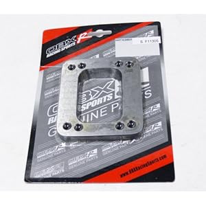

This is what people fail to relize. You can not have both quick spool and crazy top end.
On a side note, these flanges are awesome if you want to swap turbine housings all day:
http://ecx.images-amazon.com/images/...500_AA300_.jpg
There is not limit to what turbo you can bolt up to it. Well, I guess the T6 is out of the questions..but who would use that on a VQ anyway.

Quicker spool and top-end power is why this was made
And give it another 2 years and someone will be running a T6.

T6 flange turbo would be pretty hard.
We built a turbo system for a G35 that put a GT4294R in roughly the same spot that the Powerlab kit has the turbo and we ended up using one of the new Tial stainless steel back housing to make the packaging work without redoing the front end of the car.
