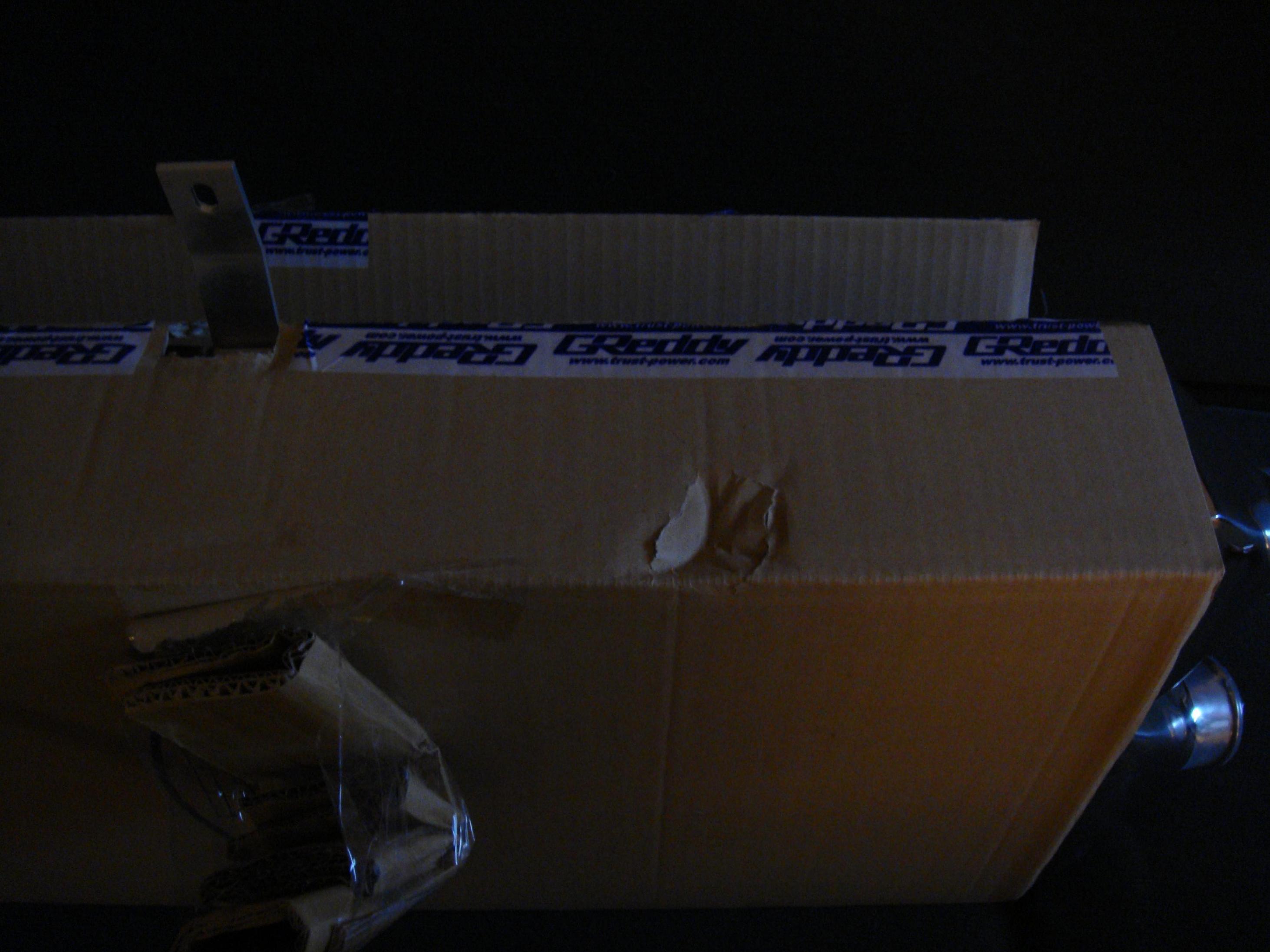

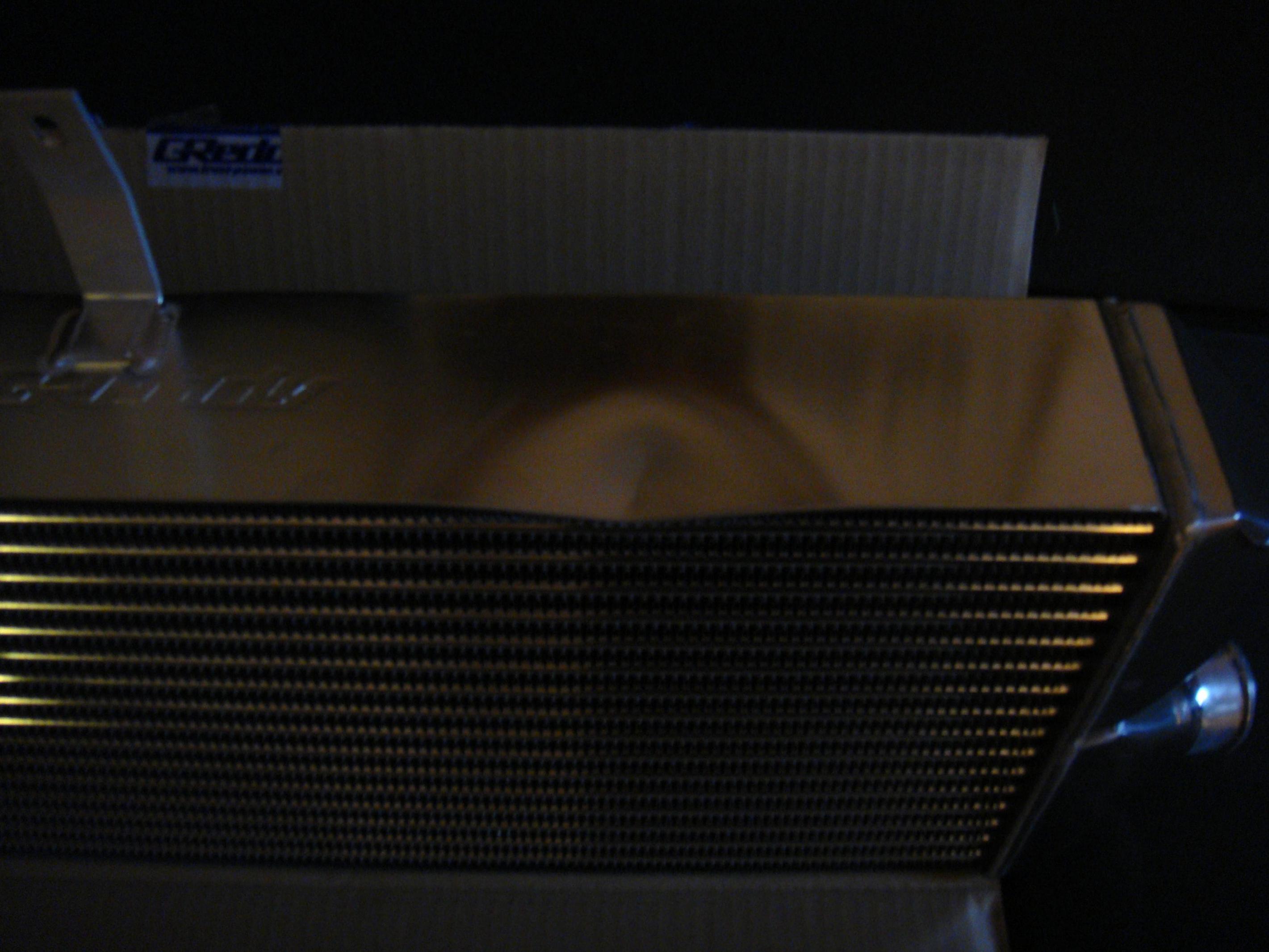

Guys,
I just started breaking down the boxes and going over everything. The one piece I was most concerned about--the IC.
Take a l@@k.
Purchase from Dan @ Speed Concepts.
I've already filed a claim with UPS.

Had the same problem with the IC from the same place. Took about 3 weeks to get a new one. Greddy/Trust doesn't package anything well and UPS is horrible.

SV1098's Avatar
SV1098
Joined: Jan 2010
Posts: 439
From: NYC
I can see that! So freakin pissed!! Why in the world do the ship an IC with other metal parts in the same box?!?
DId UPS come right away to varify the damage? they said they will call today and have someone come out to varify the damage.
