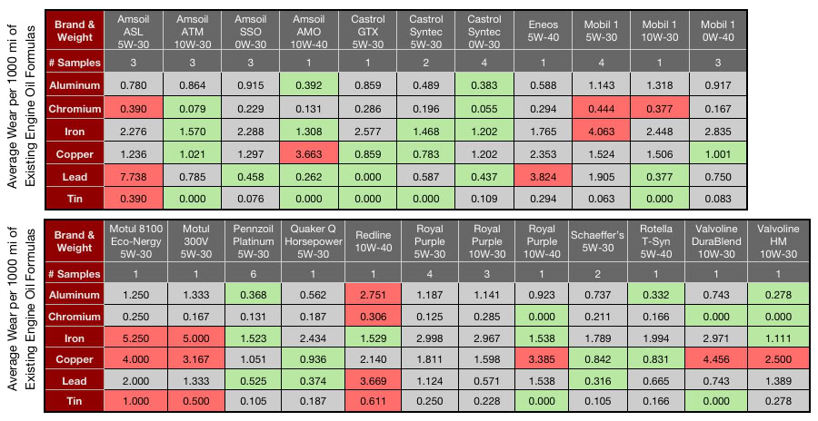

davidc81's Avatar
davidc81
Posts: 1,619
From: philadelphia, pa
i use syntec 5w-30
Attached Thumbnails 03 z with supercharger, wondering what oil you guys use?-oil_comparison.jpg
