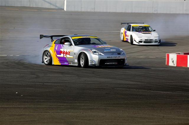

Default JIC Magic 350Z
one more good photo

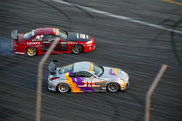

JIC and my self we have long experience. We know Japanese engine. JIC as you know we are manufacturing suspension and titanium item. But JIC here and Japan we are doing lot of racing. late1980 we start JSS Japanese race and also we made many top speed race car, we challenged 0km to 300km time trail race, Porsche cup race 1 year. Japan GT grand turismo race 4 years, FIA GT Race 3 year, also 0- 400mm drag race, here America. American Lu man race 1997.Daytona 24hrs race 1998 and Japanese N1 race 1999 and 2000 with IS300 and civic, also always D1 drift. Most our race car we are making engine and chassis ourself.what I want to say we know what we have to do this with ATI kit. If we doesn’t have experience play with Japanese car we might will make damage with drift race. This is my responsibility. I want to more engine hose power so I got system from ATI. ATI gave me dream to us. but anybody who want to extra hose power and performance every have to study and take care of engine maintenance and tuning. I like my350Z .com forum but, I don't like people looks like fight inside forum. sorry about my strong letter. If 350Z owner who has ATI system I hope every body enjoy car life with modify. my self I always drive modify car. never drive stock condition car. Last 20year I learn lot of about engine tuning and still learning and spending money...

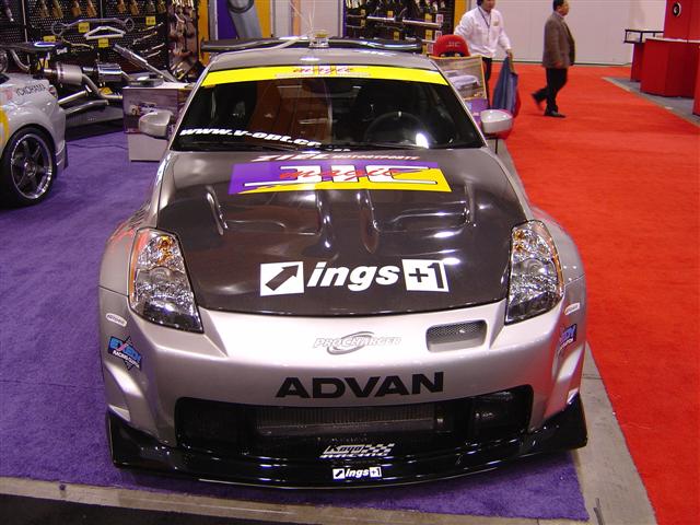

Default Oil Temp
Hi
Japanese Nissan engineer told me about main bearing. Stock bearing we can use max rpm is 6800rpm. We can go 7000rpm but they said very dangerous. I saw stock bearing looks very small not like Porsche bearing. If you want to use over 7000rpm just dangerous. You know Japanese Jun auto? They did silver state classic race. Their engine rev limit was 7500rpm max but they said they got some kind of special material bearing. But, I don't know who making. If you want to use high rpm you have to take care of oil temp. My car has extra oil cooler but still not good. My car will have one more oil cooler. If your engine get oil temp over heat you will make bearing blow and destroy your engine. I know now Nissan designing new crank and bearing for VQ engine right now. In Japan lot of engine tuner know about this info. But US Nissan they don’t know this information. But 350Z when I play at willow spring(small track) oil temp going up very high (130~140C) before install oil cooler was 140~160C.

Hi Jon,
Thanks for the great posts. The picture you posted of the ATI install looks different than my install (intake for one). What customization was done and could you be specific about the changes made (parts different than ATI kit) and why?
