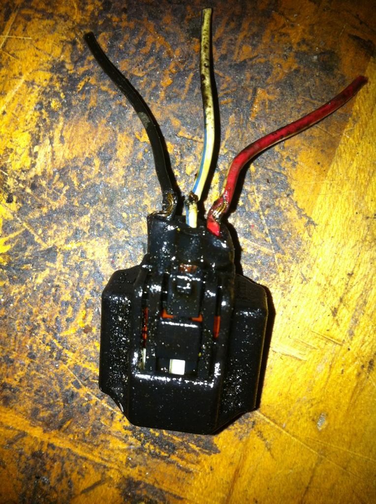

Ok so today I put the car on the lift and found this ....
Needless to say i cut the plug off and re connected it to another plug I had from a spare harness along with a new crank sensor. After that I then tried to crank the car. Now the car will not crank at all. It back fires really bad on start up.
No I feel that the plug fried my ECU ? Any one else think this ?
New question is I have a spare 04.5 manual transmission with osiris on it for my 6mt conversion I was going to do. Can I plug that ecu and try to start the car ? or will the fact its a 6mt ecu make it not work ?
Any advice would be good right about now.

doesnt make sense. you should have got a crank trigger code. and aside from that, the car will run decent with no crank trigger, it will take longer to start while it looks for the signal and then default to run off cam triggers alone and give a check engine light. i could see that perhaps with the UTEC it might not do that as the UTEC is most likely intercepting the crank trigger signal and manipulating it, and the UTEC might not be able to run without it... but on stock ECU only i dont get it.

Good chance something fried in your ECU since it looks like all three wires on that harness got shorted to ground.

That's what i am thinking but when i called uprev and spoke with Roger? he said it was unlikely that the sensor fried the ecu. Which i think is bs due.
