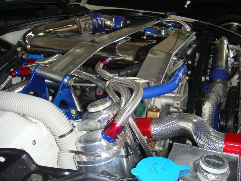

I went with alcoholinjectionsystems windshield wiper reservoir kit initially, hen switched to trunk mount with the TT going in..
http://www.alcoholinjectionsystems.com/
Rodney at AIS is a HUGE help with setting up systems...i originally had a dual point injection with progressive controller, injecting just before the SC to cool the intake charge into the compressor, and then right before the throttle body.
The new TT setup uses 3 injection points on a kinetix plenum for better distribution and atomization.
From what I was made to understand is that with an on/off switch, the hump in the tune is more diffficult to tune out vs a progressive controller.
my 2cents.
